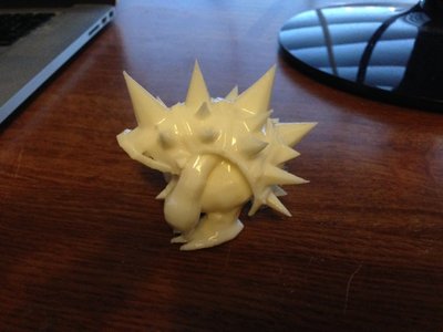

Just to re-iterate how much I'd really like some type of feature for solid infill a the top of the support layers, I just printed a model that I had to create 12 processes to print.
Step 1, slice the model.
Step 2, go through every layer and find where a new bottom surface started, make note of several layers below and above those layers
Step 3, Add a new process for every alternating point between those points.
Step 4, modify every other process to have 100% infill (actually I think I used 95 or 90 or something) and then all the ones in between only had around 25 or so.
Multiply layer number by layer height to get starting and stopping mm for each process.
Step 5, Reslice model, fix all the mistakes I made, carefully look and make sure I did it right before printing.
I'm happy that I was able to do this with S3D but at the same time it was really annoying. Hoping for a feature still.
Model has lots of pointy things on the bottom, fingers, spikes etc and I wanted those to be nice and clean on the bottom just as on the top.
