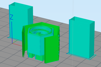

A lot of neat ideas here. I also would really like to see a purge wall implemented. I'm interested to see wipers and brushes people have implemented too. A brush seems like a good way to go, but getting the gcode optimized seems tricky. I liked the technique of getting the support material only into its own process as described above. After some tinkering I got it to work fairly well. In the attached image you can see a cutaway view of the setup. The only thing that's cut away here is the front section of the skirts, so you can see support material under the part. In the left rear position there is a box with a brim that uses the left extruder. In the right rear there is the same thing for the right extruder. The object (a nut) is elevated from the table on purpose just to force support material under the part for a test. There are 4 processes. First is the left extruder object, followed by the nut support material (both using left extruder) followed by right extruder object and finally the nut object build material. I used 2mm retract. This is a case where I just want support material and build material, not necessarily "2 colors". I found the brims on the rectangle objects necessary because on the printer I was testing with (Flash Forge Creator) did not seem to prime well before printing began. Also support in S3D for priming both nozzles leave something to be desired. Anyway, the tall skirts worked well to brush off most of the bad stuff before the nozzles reached the object.
This is by no means optimized, but does seem to work. I'm going to try it on my Replicator 2X later. The nice thing is that using this as a template and dropping in new models then assigning the models to the processes may make things easier for me to use S3D for dual extrusion. I too was going back to Makerware which really bugs me due to the lack of good profile editing support and less features than S3D.
I'll attach the factory file too in case anyone's interested.
