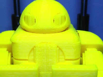

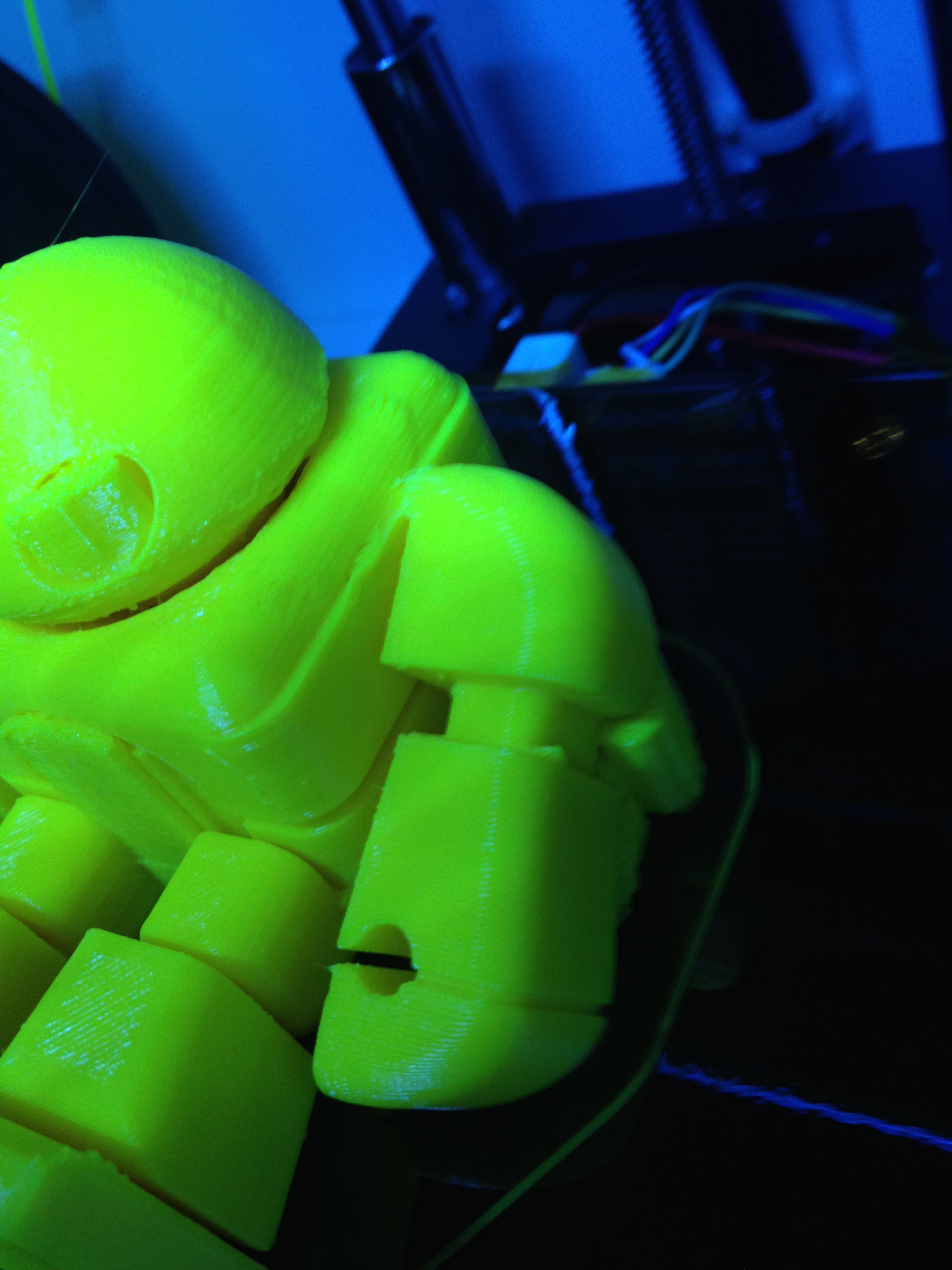

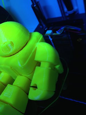

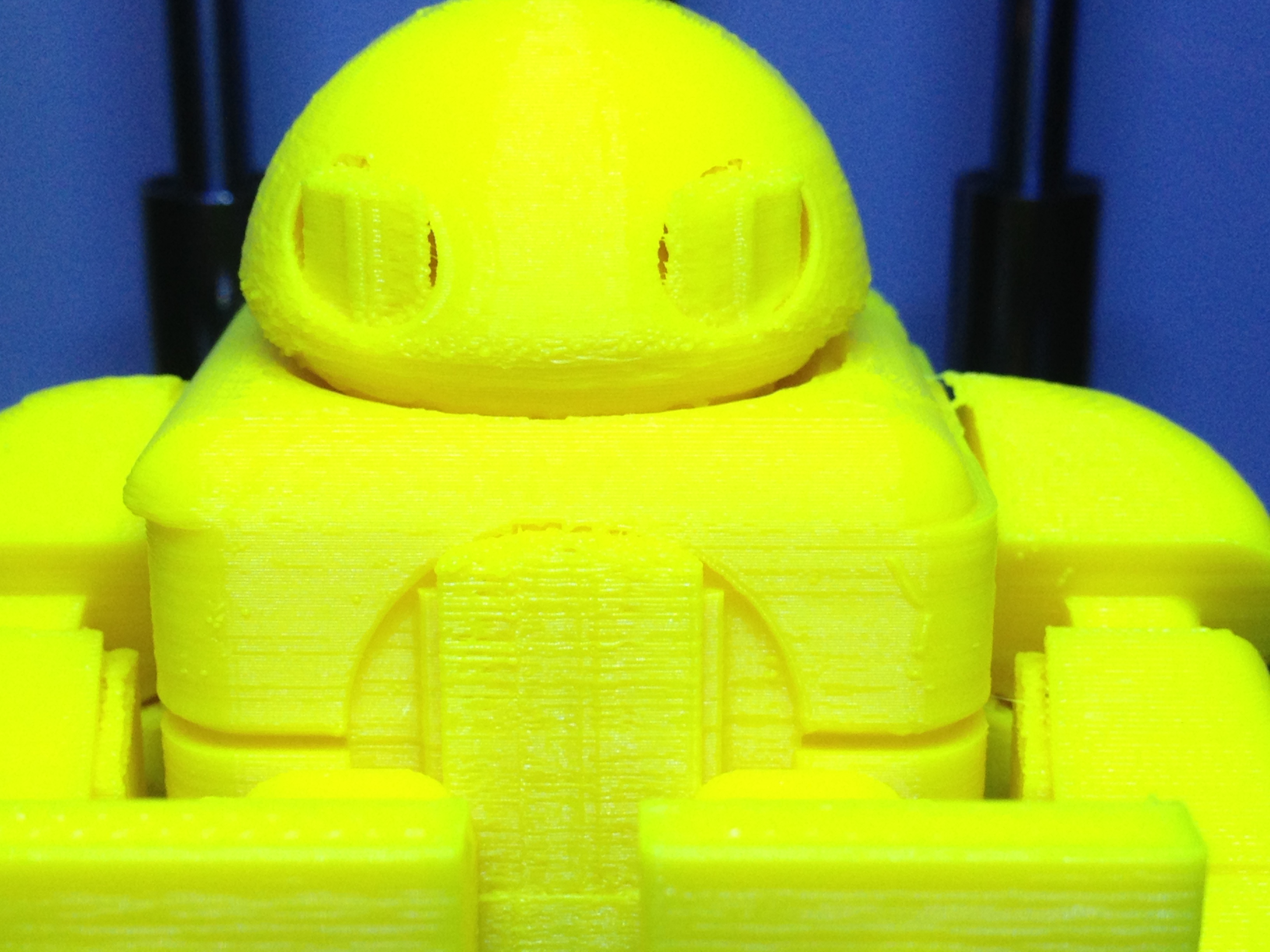

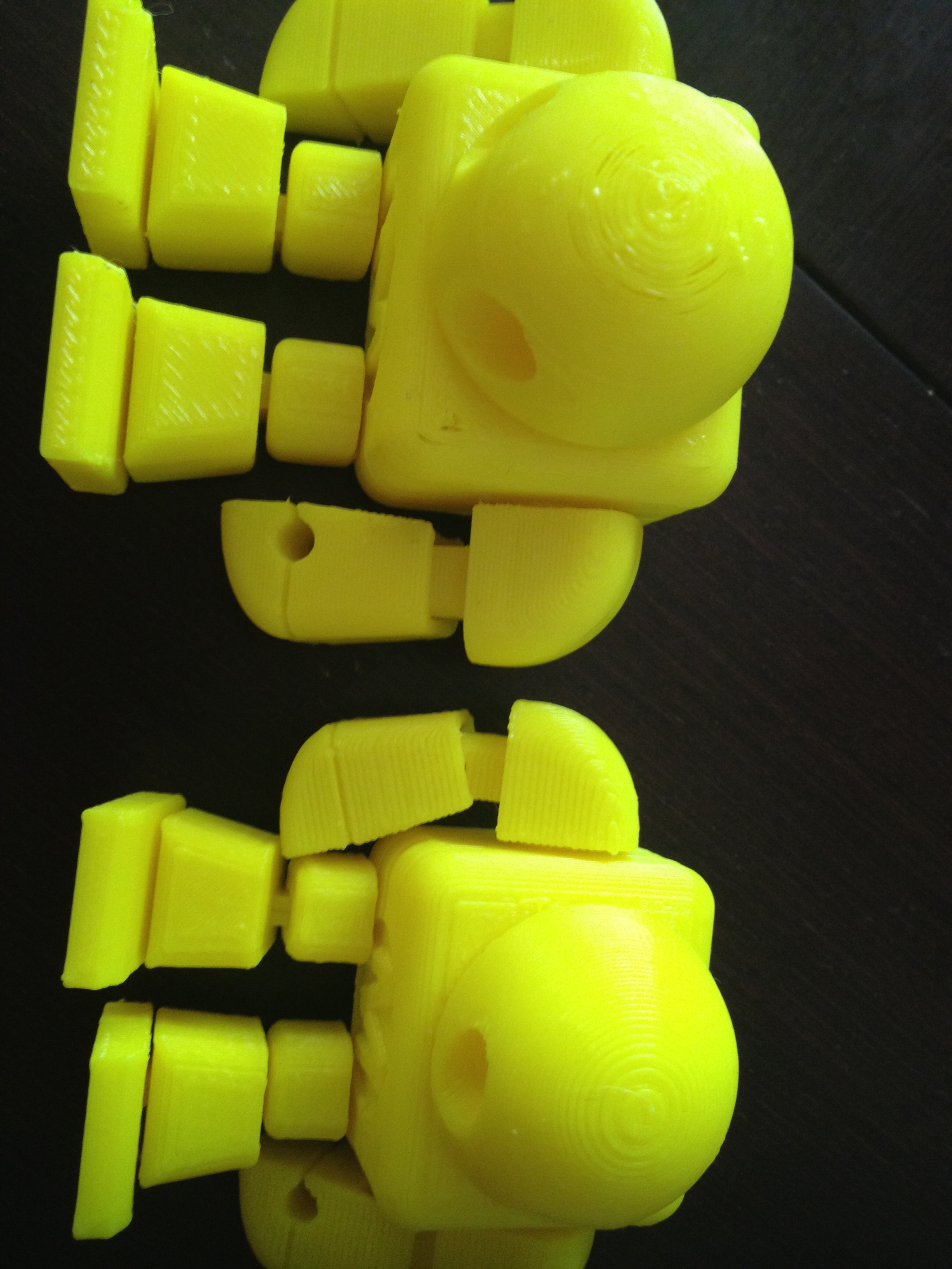

Print successfully!
I printed same Make robot with both softwares.
Flashprint made a lot of errors, and all parts are impossible to move by hand, in fact I broke some parts trying it.
Simplify made a great job, with less quality settings that Fprint, the finish is really good, and the robot move the most of its parts.
Great!
Flashprint: big print with a lot of errors
In the upper, Flashprint with medium quality
In the lower Simplify3D with Low quality setting
Note the differences... far far away imho

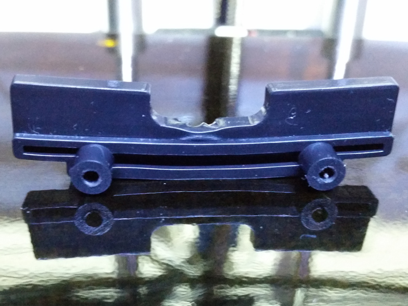

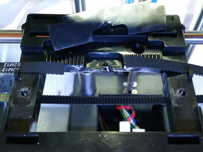

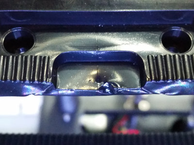

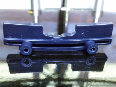

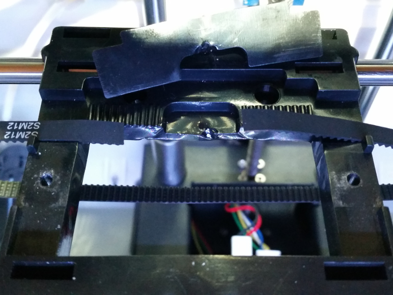

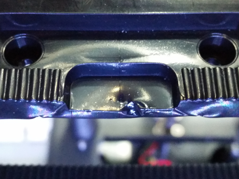

So I tried printing using DUAL EXTRUSION using 100% FlashPrint (using it's Slic3r setting) to see if FlashPrint had the same problems with dual extrusion. It did not. But about 30% through my print, my printer's X axis belt broke off. I disassembled the print head to take a look at the carriage and saw that the X axis belt clip on the carriage (the piece that holds the belt to the carriage) had slightly melted from overheating, and so the belt came off. The heater cartridge wires were touching that area of the carriage and probably got too hot and melted it. Because the clamp melted, I cannot reattach the X axis belt. Once I get this fixed, I'll make sure to insulate the carriage from the heater wires.
So because of this problem I cannot do any more printing for a while until I get a new carriage and belt clip to replace the melted ones.
Take a look at the problem that happened during my first DUAL EXTRUSION test using FlashPrint. Look out for this problem if doing dual extrusion with ABS and ABS at 230 C for both heads. If your heater wires are touching the carriage like mine were, this could happen to your Dreamer too.
In this picture you can see a clear indent near the middle of the front of the carriage's belt area. This is where my heater cartridge wires were touching my carriage and so they were transferring heat to the carriage. When this problem happened I was dual extruding ABS and I had my printer enclosed with the lid on, and no fan running, and it was a very hot summer day. The room temperature was about 100 F. This combination of the wires touching the carriage, it being a very hot day, no fan running, and the lid on probably all contributed to the melted carriage.
UPDATE: FlashForge is sending me replacement parts. They are an excellent company when it comes to customer support. Their engineers are working to solve this problem. I'm sure they'll find a good solution to it.
A quick solution is to simply move the wires away if they are too close, and pull them up. The heater wires are pretty stiff and should not easily move back down towards the carriage. Another quick solution is to cover the X-axis belt area with a small bit of ceramic tape to insulate it from the heater wires.
