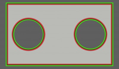

parallyze wrote: ↑Sat Oct 03, 2020 1:26 pm
Omikron wrote: ↑Fri Oct 02, 2020 5:08 pm I consider myself an advanced user
Omikron wrote: ↑Fri Oct 02, 2020 5:08 pm 3. Regarding the horizontal size compensation, is there a way to input a percentage? Inputting a value in mm is not helpful considering different models will have different values here.
If your model shrinks by let's say 3% horizontal size compensation won't fix that, that's not really what it's there for.
Example:
Assumed shrink by 3%:
To get the holes (48.5mm diameter) up to their original size you'd need to use a negative value. But this will also further reduce
the outer dimensions of the part (164.9mm wide).
And even if this would work somehow - it wouldn't fix the two holes now being too close to each other (97mm instead of 100mm).
It doesn't seem clear to me what the mechanics of horizontal size compensation are then. My assumption was that it would scale the whole object enough to compensate for the size difference. In such a cases, wouldn't the holes and their relative distances scale as well?

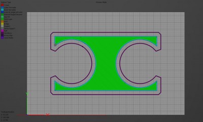

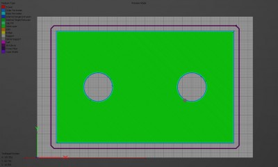

Omikron wrote: ↑Thu Oct 08, 2020 2:29 pm It doesn't seem clear to me what the mechanics of horizontal size compensation are then. My assumption was that it would scale the whole object enough to compensate for the size difference. In such a cases, wouldn't the holes and their relative distances scale as well?
It changes the outlines, just like the tooltip says ;)

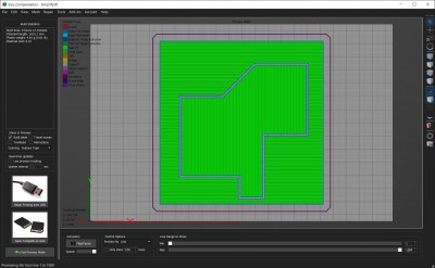

Looking at the object from the previous post right from the top:
Positive values will expand the outlines, negative values will inset them.
Here's extreme values (-10mm/10mm):
It's easy to see how it does not affect hole distance. It's not a scaling function. This can be used to fine tune dimensional accuracy.
Imagine over-extrusion on purpose. The thicker perimeters would make all printed objects a bit bigger than they are on the outside
and holes would end up smaller than they should.

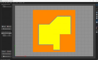

There's no outlines added or removed. Actually the tooltip says:
"A negative value will inset (shrink) your model outline in the XY plane. Useful to account for small dimensional differences in print quality. Set zero to disable."
And that's exactly what's happening:
Two parts, two processes. Very low tolerances between inner/outer part (0.001mm).
Inner part scaled to 95% along X/Y. Even moving the part won't fix the different distances to the outer part all around.
Process for the inner part set to a compensation of -1.0mm. The outline of the part is now smaller, distance to the outer part is now the same all around. If not inset/shrink, how'd you call it? Expand/Contract like in Photoshop?

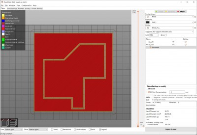

Just curious, which Slicers do support such a compensation? Shrink rate depends on many factors so I wonder if there's really a "one value fits every object using this material"-value...
In Slic3r/PrusaSlicer it's called "XY Size Compensation", works exactly the same like in S3D and it's tooltip says:
"The object will be grown/shrunk in the XY plane by the configured value"

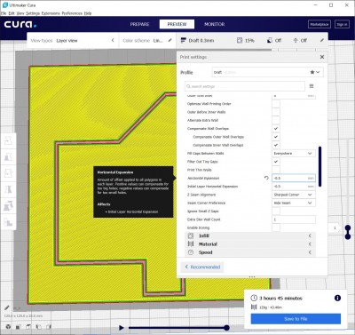

Cura 4 -> "Horizontal Expansion" -> "Amount of offset applied to all polygons":
Edit:
Cura 4.6 seems to have an additional "Hole size compensation"-feature.
