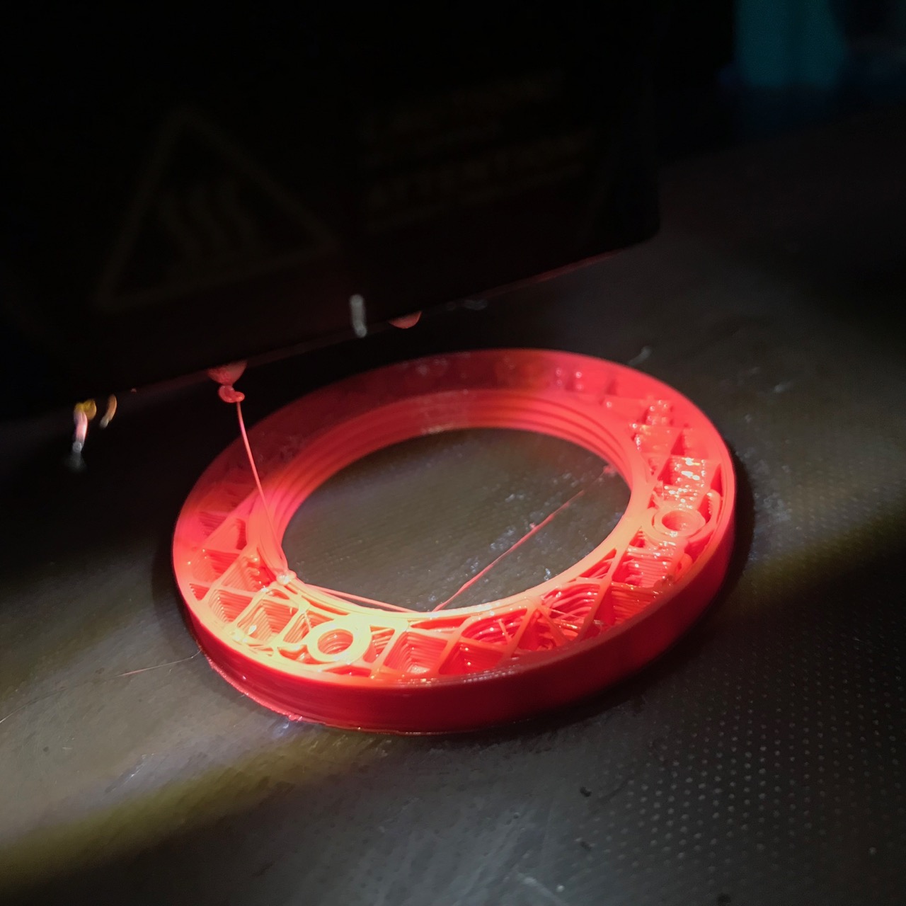

OK, so I've corrected a few things, and done away with the Simplify3D Tool Change Script, and added a simplistic one I used in the DM profile (I will revisit this sometime, once I have uncooked the DM head..hmmm the joys of trying to do something different).
I have tested it so far, and it is working OK, just a little start dribble which is some legacy prime, that has crept in when editing the start scripts for each and both extruders. Interesting that S3D does allow different settings in here.

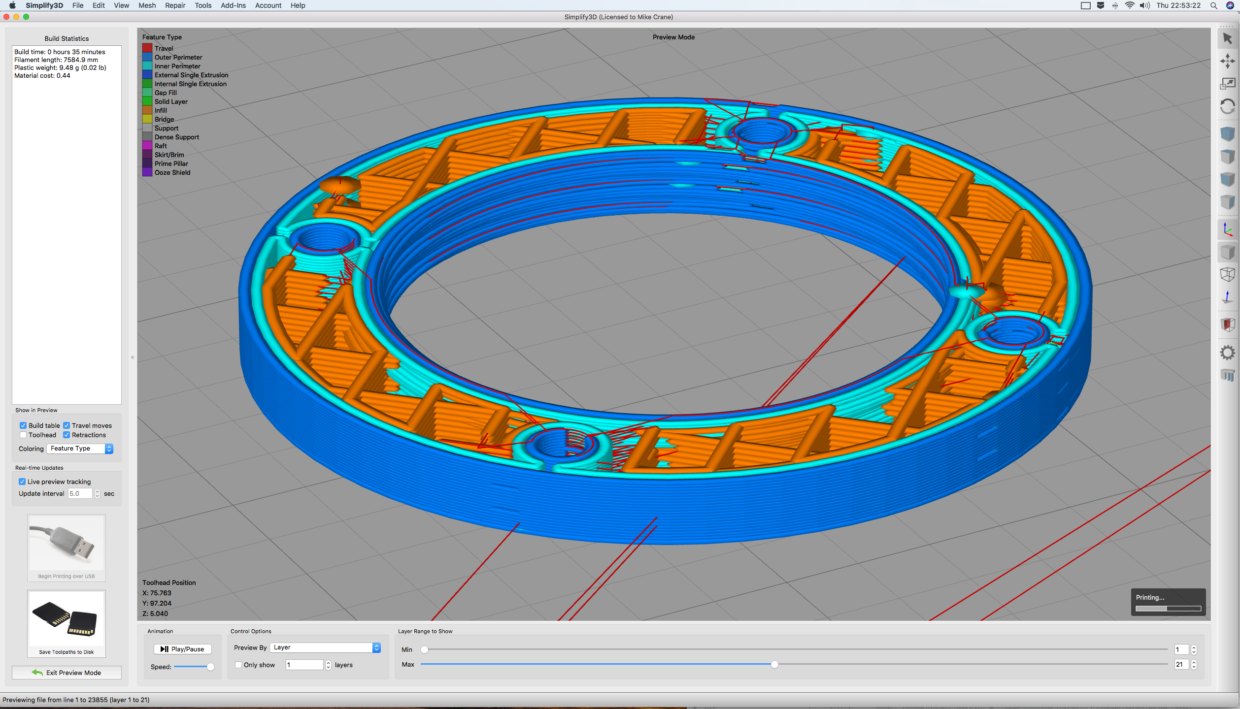

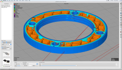

0.3mm with 0.8mm infill at 0.2mm layer heights

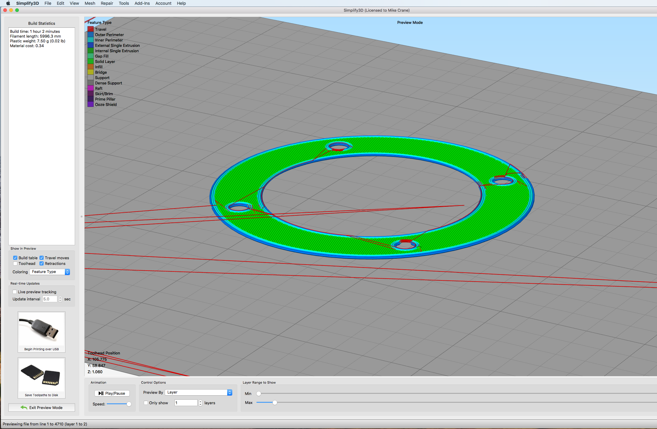

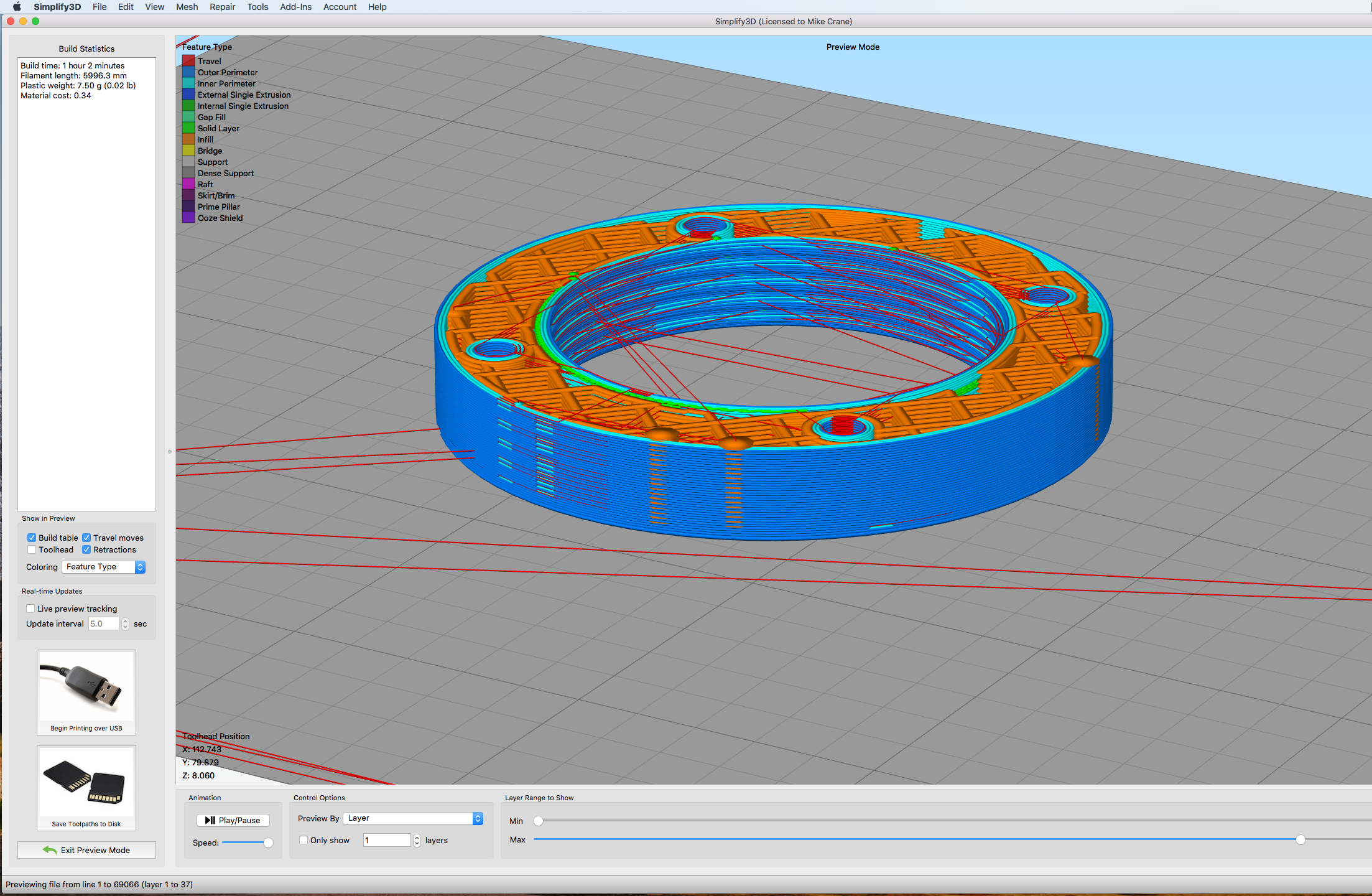

As you can see from the next images, all sliced OK, unlike previous.
I have set this profile up so Left Extruder, aka 0.3mm nozzle works across the print, same with Right Extruder but with the 0.8mm nozzle. No support or bridging settings have been done lately, and the Both Extruders uses 0.3mm for everything bar the infill which is at 0.8mm. Maybe this might help some of you get a leg up using Simplify3D with a Robox. In the .frm I have added an Abort print macro that calls the right GCode to shut the machine down after using Stop in the Machine Control Panel.
