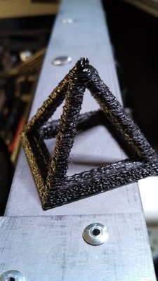

Any update on this? I'm evaluating the software (v 1.1.4) and first couple prints were fine and then suddenly showing same behavior with these bumps, as others. Solidoodle 3 here.
Can see bumps in preview which of course, show up in final. The "pyramid test" looks horrible :-(

"Fixed". If it were fixed, then explain (other than the it's you fault, excuse) how it could occur. I haven't changed a single setting, prior to this issue (I've only changed what's been suggested, in this thread).
If you want me to purchase this and this is the type of answers I am to expect, then I guess I can save my money and just run with what I have now. Thanks.
I've uploaded a pic already. It prints EXACTLY like the preview is showing it. I can go an extra useless step and upload the final print as well, but as I said, just like the preview represents.
Solidoodle 3 and software version I am using is the trial software you guys sent me, version 1.1.4. Both of which, I have already specified.
Actual print
Actual print
Preview of print
Preview of print
