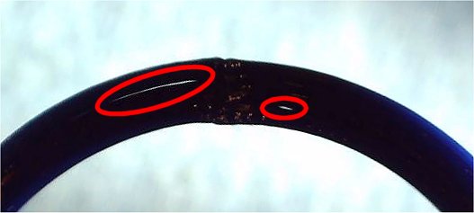

Ok, I put a brand new spool of eSun PLA+ on the printer to eliminate any filament moisture issues. I did a calibration cube, and actually left the extrusion multiplier slightly high. I should get a 0.40 mm wall thickness, and I'm getting between 0.41 and 0.42 mm. I pruned my model down to speed up testing, and here is the result:
I still have significant gaps between the perimeter passes. This section is a couple mm thick, so the gaps are on all the layers in exactly the same locations.
As promised, here's the factory file:
Perimeter Gap Test #1.factory
(43.29 KiB) Downloaded 259 times

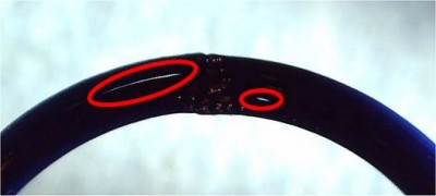

Before I printed the test above, I ran a test to fine tune my retraction & extra restart distance. I set up a 3 by three grid of models, varying the parameters up & down slightly. To do a fast check, I only print the lower 5 mm of the models, which results in a 2.4 mm thick ring. With a 0.41 to 0.42 mm actual extrusion width and telling the printer it's 0.4 mm, there should be NO gaps, without any need for fancy extrusion width adjustments or gap fill.
Here is a photo of the model that came out the best:
I still have gaps.
I stripped the S3D file down to just this model & process settings, and here is the factory file for that:
Perimeter Gap Test #2.factory
(14.9 KiB) Downloaded 276 times

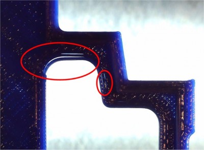

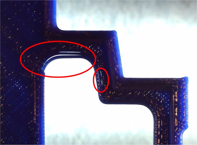

I tried tweaking the model. The place where I'm having problems is where I have a 2mm wide border. I've got a 0.4 mm extrusion width, so it should come out just fine. I shrank the border to 1.9 mm on the theory that it would help to mash things together & hopefully get rid of the gaps. No cigar...
Update: The new process settings didn't help. I just finished adding a lengthy reply with photos, and the forum software blew it away. I will re-post later today, but I'm going to move this to the Trouble Shooting forum, where it really belongs. I initially replied to another user's post about the same problem, but I didn't notice that it was in the General forum.
