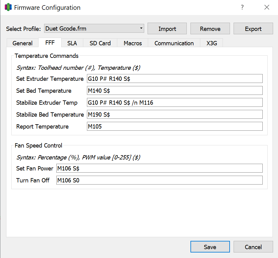

Posted: Mon Mar 06, 2023 7:15 pm
by bcprint3d
S3D-Jason wrote: ↑Tue Jan 24, 2023 1:32 pm What printer are you using? Let us know what commands you need to change and that will make it easier to propose the correct settings.
I am using a E3D tool changer, which requires changing the ALL of the commands listed on the old Firmware Configuration->FFF window. Without the ability to change these settings, S3D v5 will not work for the Duet firmware with multiple extruders.
