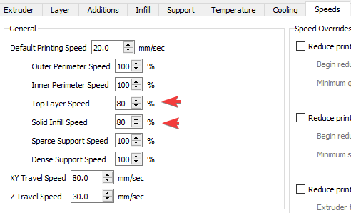

BTW for those experiencing this flaw. you may also have to change SOLID INFILL SPEED to be 100% as well. I set top layer to 100% but I was still getting split layers. I changed solid fill to 100% and that fixed it.
Re: Any idea why its splitting up the layers like this?
Posted: Fri Jun 02, 2023 10:17 pm
by gearsawe
nerys wrote: ↑Fri Jun 02, 2023 6:20 pm BTW for those experiencing this flaw. you may also have to change SOLID INFILL SPEED to be 100% as well. I set top layer to 100% but I was still getting split layers. I changed solid fill to 100% and that fixed it.
Thank you Nerys. I thought had all my speeds the same! in my settings guess the top speed was 50% unknowingly and explains why it was taking longer to print in 5.02 vs 5.1 . Now we know this was intended but I could not understand way at the time. makes a little sense now. never like the unconstructive help either.
to be clear just make these two the same
"happy printing"
