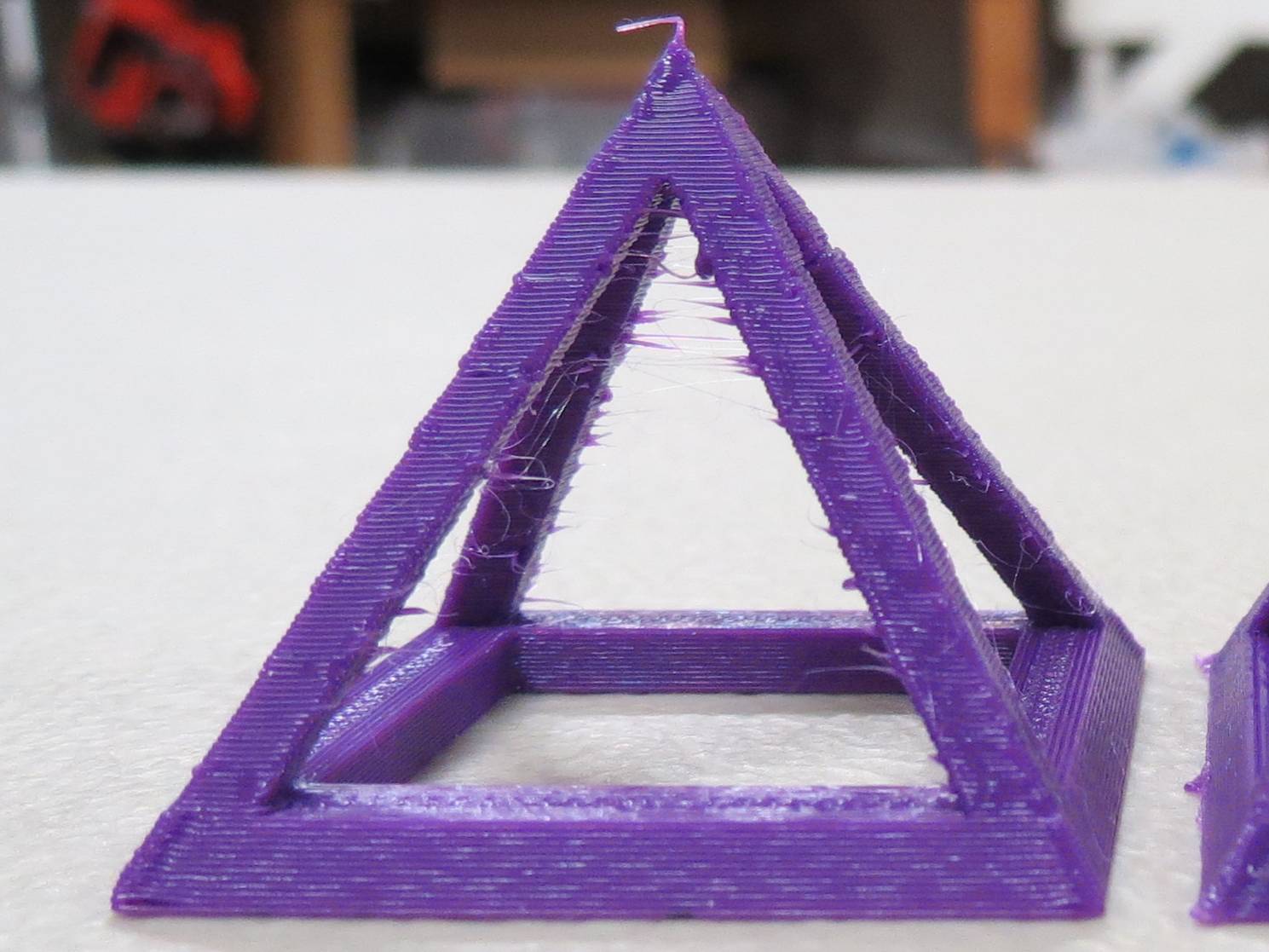

OK, here is my attempt with a new factory built M2, and the complimentary purple PLA. The left is default medium (0.25mm) resolution, and right is default high (0.15mm). I think the only thing I've changed is to 4 outer layers, instead of 3, and some of the gcode script.

It seems that you are also getting pretty much the same result.
I am not glad that it came out this way but I feel better cause it's not only me.

Yes, it's still at the default of 190 degrees. This is all pretty new to me, so I haven't done too much experimenting yet.

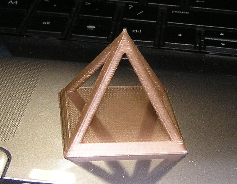

It definately looks like you are printing to hot. Good job on testing the hot end.
When I was trying to print test pyramids I went through a couple of issues as well.
You might want to check out :
http://forum.simplify3d.com/viewtopic.php?f=8&t=109
I think your on the right track.
PLA Pyramid .250 layer 180°

FWIW, I just printed this on "high" resolution, using 190, 185, 180, and 175 temps. Overall, the 185 was probably the best, though it's not that much better than the 190 default. 180 was at least as good, but it had a couple significant issues in it. I'll stay with 185 for a while to see how that works.
