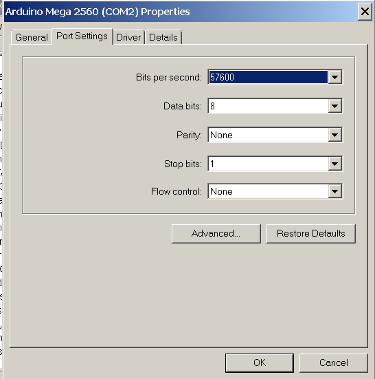

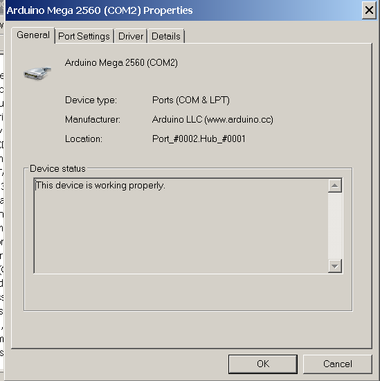

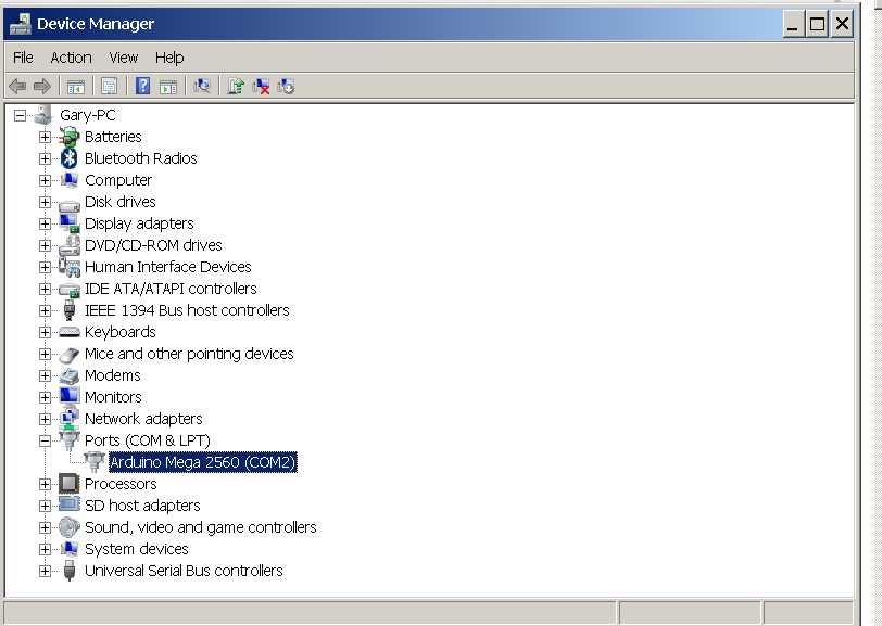

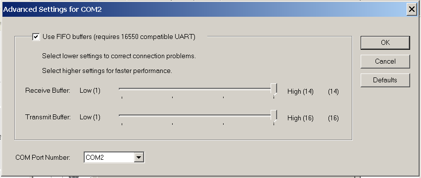

Lateralg
Posts: 30
Joined: Wed Mar 20, 2013 5:10 am
Location: Green Valley, AZ (Winter), Howell, MI (Summer)
Re: Marlin firmware on GEN6 electronics
Karl,
Here's what I see. Baffles me.
Dang; I uploaded 4 png images but don't see the on preview. I'll submit & see what happens.

Simplify3D
Site Admin
Posts: 311
Here's the images for the above post.

Karl_Williams
Posts: 61
Joined: Wed Mar 13, 2013 1:26 pm
Have you tried connecting after lowering the values for the receive and transmit buffers under the advanced tab?

Lateralg
Posts: 30
Karl_Williams wrote:Have you tried connecting after lowering the values for the receive and transmit buffers under the advanced tab?
I think so, but need to double check.
