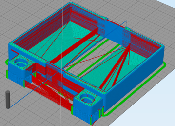

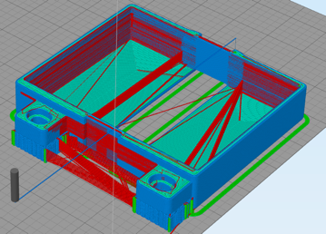

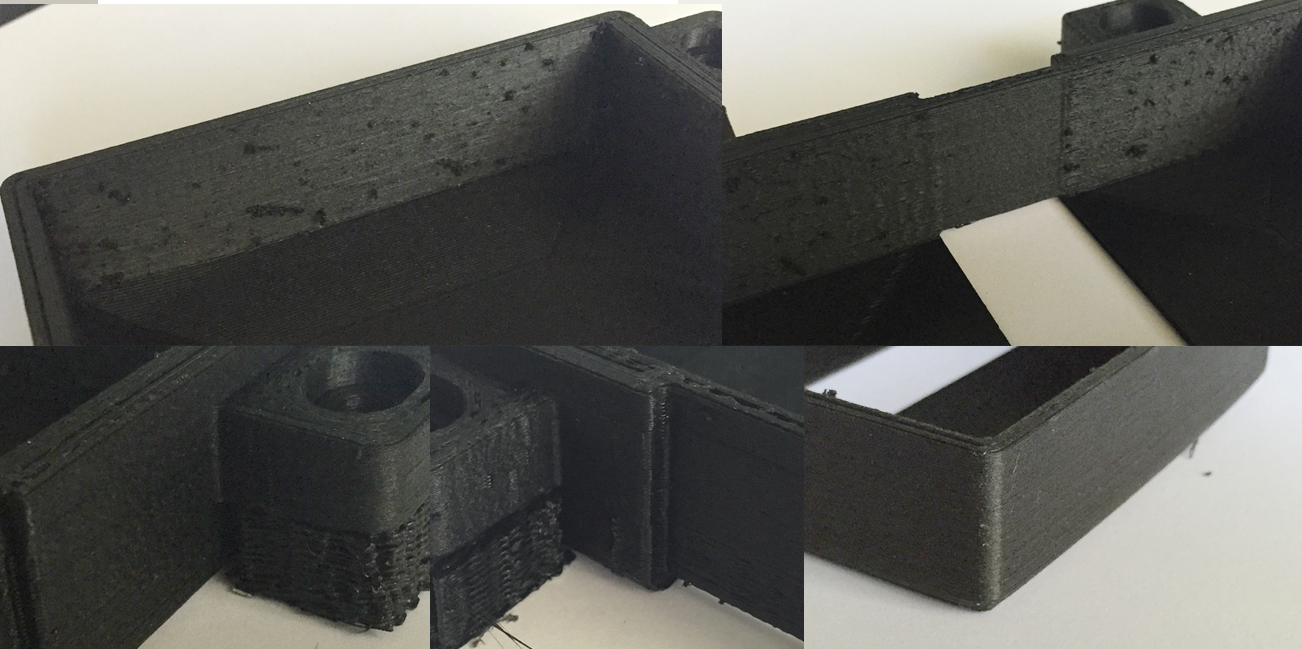

So I got a full print last night, the defects are somewhat minimal. And they are all on the inside of the tray.
Posting the below for for others to see what worked to get a pretty decent outer surface and an inside that needs minimal post processing.
This part has a fairly small audience and so I have expended more time/energy than is warranted but it was a learning experience.
( I might sell 5, so 16 hours of tweaking over a week is too much time).
I appreciate the input/advice from the forum members.
I ran the infill down to 50% which took 2 hours off the print time but it leaves a less professional looking top surface so if I print it again I will got back to 100%.
I think that setting is also what changed the layers from the diagonal fill to a rectangular perimeter fill.
The diagonal produces a stronger set of layers.
It was the cleaning up of the corners on the mounting tabs which is of the highest value as it was near impossible to get them cleaned up post print.
Hope this helps others.
Thanks,
M./
Preview of tray shown in photos
small defects on inner walls which can be dealt with, outer surfaces are excellent.
