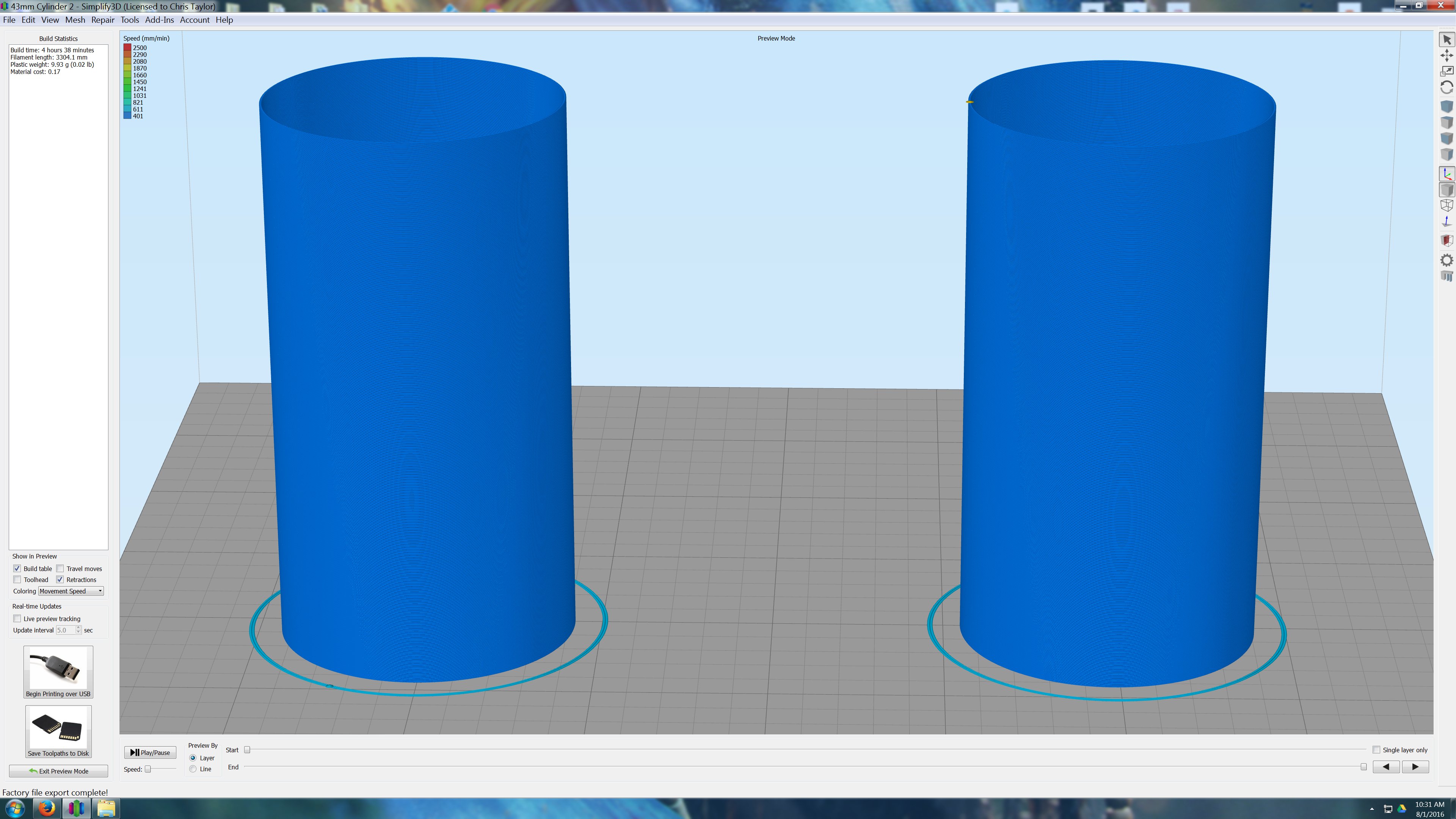

import 2 cylinders spaced apart.
run the preview. you will see that it retracts when it moves from one cylinder to the other cylinder.

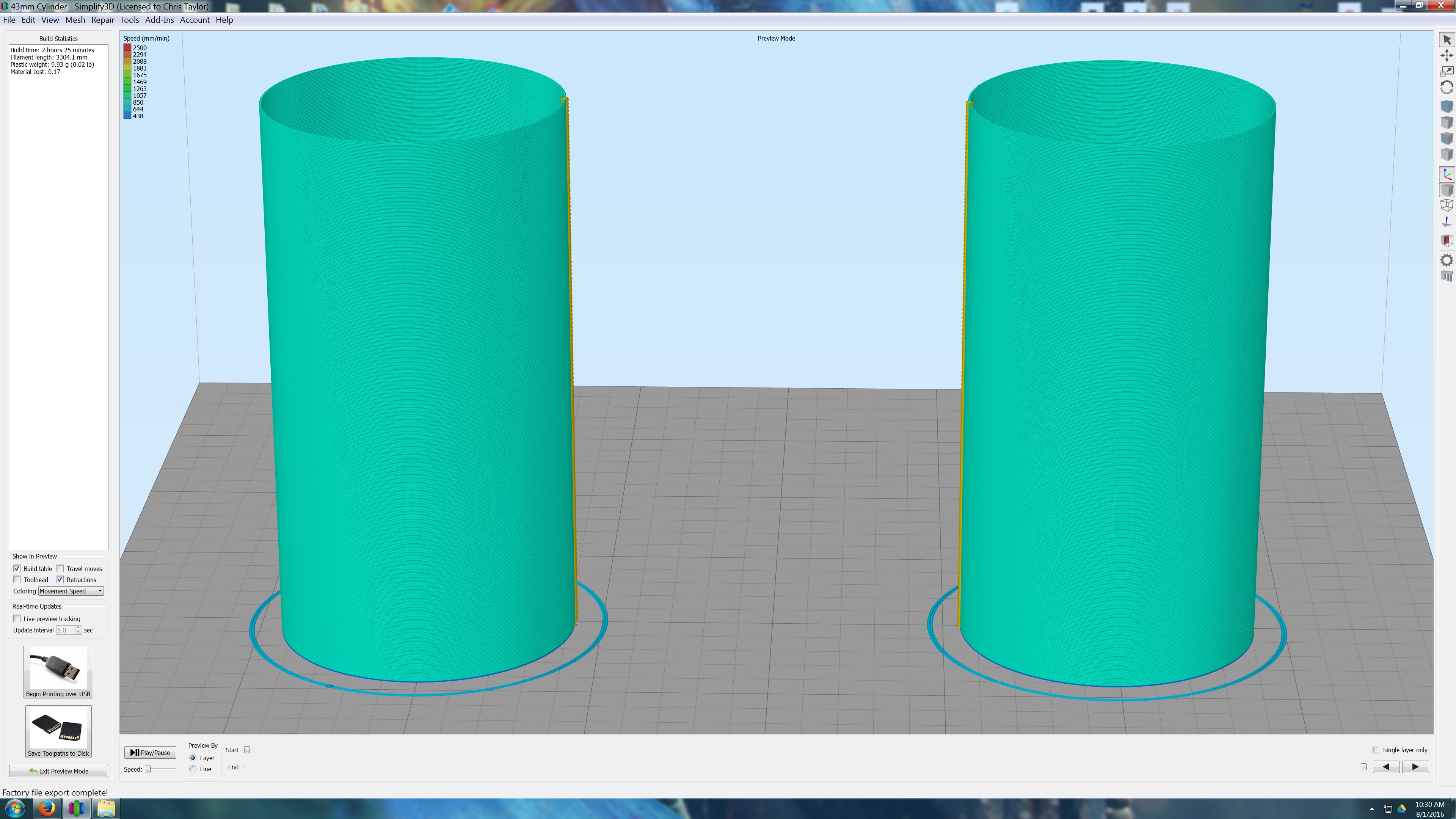

NOW create a duplicate process and make each process one cylinder so each is in their own process
now it will not retract when moving from cylinder to cylinder across the open space.
from a lay persons perspective it seems that once you make them separate processes it no longer sees the space between then as existing at all.
