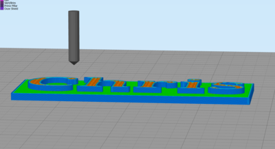

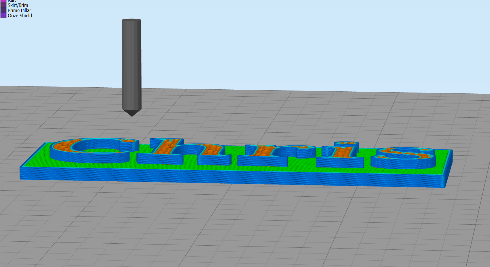

Is it normal for the extruder head to have a 5mm or depending on what you set your zlift at. To be off the part ? In the whole sequence not just the zlift. If you look at the pic thats what i see through the whole print in preview layer mode. Which is not normal.
On my laptop thats what i see goes up and down on lift but the whole head is off the part just like in the picture through the whole print. Basically printing in air in layer preview mode. If your not seeing it on your end maybe its my
laptop ?
But in single line preview mode the extruder head is on the part like normal.. And jumps and comes down like it should.
Also when i start the print with zlift enabled after i level my bed of course. The head will come up because of the zlift and wont come down again. Making a mess of my first layer.

You have your z-hop ("Retraction Vertical Lift" on Extruder Tab) set to 5.00mm. That's an unusually large value.
The simulation view shows the toolhead position at the beginning/end of the layer (after retraction/hop), which is why it appears to be "up in the air." With "travel moves" displayed as dkightley suggested, you will see the actual path for that layer -- including the "hop down, extrude, hop up" path. But the toolhead image is not painted continuously, so it will always appear at the layer start/end height.
I recommend changing your Retraction Vertical Lift to a smaller value. You shouldn't need more than 0.5mm (I typically use 0.1-0.2mm).
