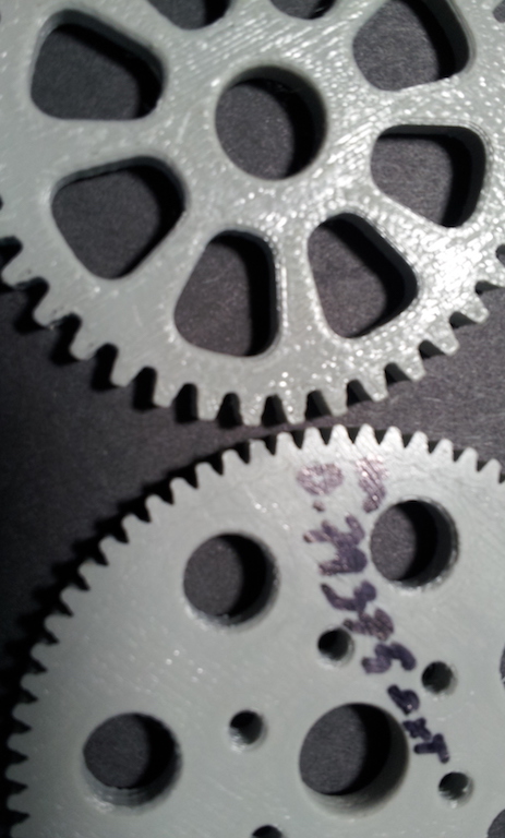

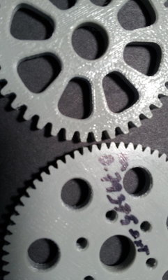

You should be able to get prints good enough for general use (may have gaps but, for light loading, should be okay. Especially if you used similar settings as I posted above.
I like well melted plastic so, I pump up the Temperature to ensure the bottom and top surfaces close gaps (meaning, the strands of FF melt to form a nice layer.
If your machine speed is too fast, slow it down a bit. Also, slow down the Acceleration Jerk (that will help with many prints and not shake your house). I set mine to 2 (default was 20 !!!!).
photo of Module's 0.7935 and 1.25
