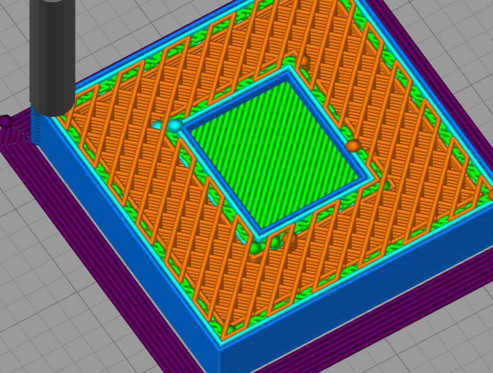

This is definitely still an issue in the latest 4.1.2 version. In any print with low infill and internal floors this leads to issues, sometimes even causing the print head to crash into the uneven surface. Here's a pair of images showing what seems like a worst case scenario.
layer 1.PNG (112.34 KiB) Viewed 3434 times
