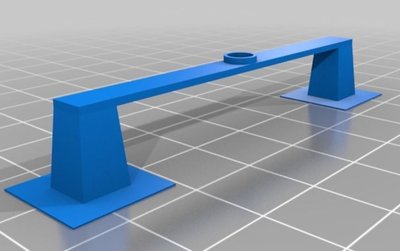

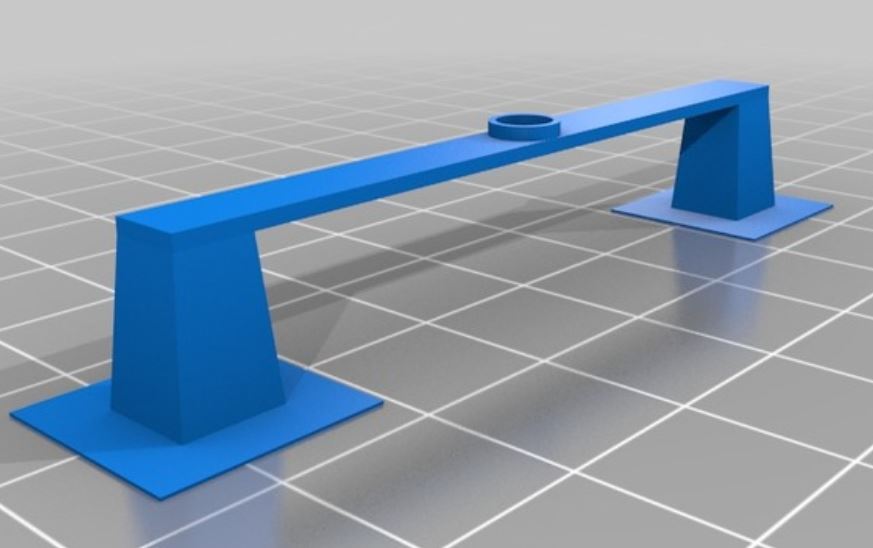

For start I believe you are using part that is "too complex" and "too big" for this test. You are fighting with Simplify3D properly recognizing bridging, time to print the fairly big part with the unknown of the "new material".
May I suggest you try something simpler, like this for e.g.: https://www.thingiverse.com/thing:12925
It is perfect bridging test, prints fast, Simplify3D properly recognizes the bridge, so you remove all the obstacles you have and just focus on the bridging thing. Running it at 0.25mm layer would in my opinion be optimal for test. There is also a scad file so you can shorten it to 3cm if you don't want 5cm for testing (in my opinion 5cm is perfect).
Furthermore, you can drop 5-6 copies of the same model on the bed, set each of them to be printed with a different process and create 6 "same" processes with a single change on each of them. For e.g. you put 5 of them, 5 processes, all same except speed is 50, 55, 60, 65 and 70% for bridging. You find the best one, next session you print 5 again but speed is same (whatever you find in prev run is best) and you select different values for multiplier 80, 90, 100, 110, 120% .. do a run etc etc ...

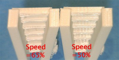

Here are the results of my latest bridging speed tests. Both were run with the perimeter bridging option turned on. The 65% speed was done with a Bridging Extrusion Multiplier of 150%, and the 50% was done with 120%.
50% is still the best I've tried. 25% is too slow, and 65% is too fast.

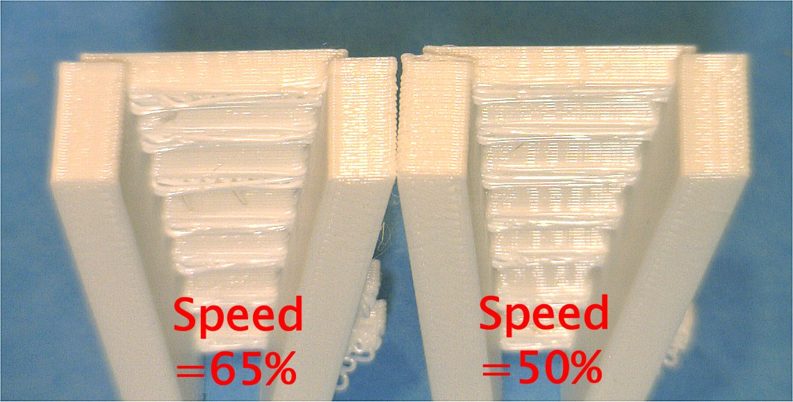

gwhite wrote: ↑Fri Aug 18, 2017 9:25 pm Thanks for the file, I'll check it out this weekend.
@gwhite Thank you for posting this write up! It was a huge help. I did as you did to a degree; Speed 50% Bridging Extrusion Multiplier 83%(is this being based off your normal Extrusion Multiplier?) Mine is currently 0.93. I have the Fan set to 60% a couple layers before too & a few layers before drop the T0_Temp_245--->240 then return T0_temp_245 .The results are out standing for a .6nozzle @0.72 Extrusion Width using Esun Transparent PETG. I will post pictures of how well it came out possibly later this evening. :?: :!:
