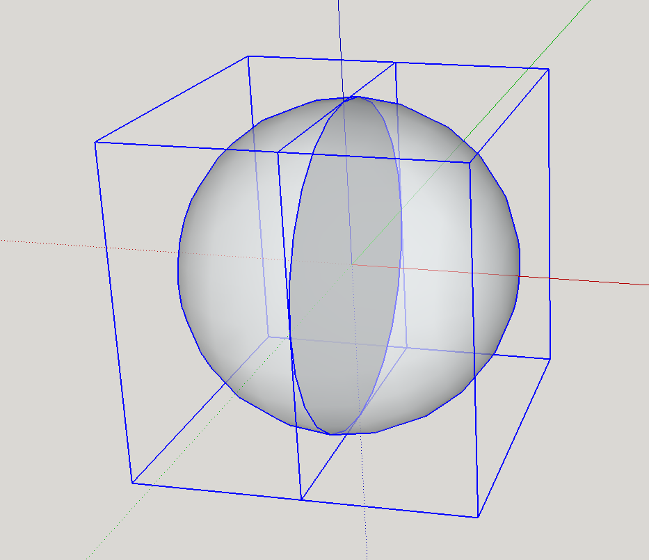

Here is a drawing of a sphere. really 2 half just side by side.
When imported as a STL. both half at the same time
I get 1 sphere. with no visible wall
as a test I say print it...
Infill is set to 10% but no visible wall.
When imported as 2 separate half I can affect either side and get it to work. with caveats.
1: How do I know the 2 halfs when printed will be joined. also how do I know the 2 half are in the correct place.
as S3d when importing them just drops them on the center of the build table. then I have to manually move them around.
for a simple shape such as this? no problem... for more complex shapes? its risky.
-S

arhi
Re: Solid and hollow side by side. how to?
TheSniper wrote: Thu Mar 08, 2018 7:36 am Care to post an example disproving my issue? instead of just disagreeing with me? Im looking for a solution how to etc...
it's rather simple, the part of the object you want hollow, you drill out in your CAD software.
what I'm showing with multiple shells makes sense if you need 20% infill there, 50% infill with hexagons over there etc.. but if you want "this part of the object needs to be empty" - cut that part out ?! that def. is not a slicer's job.. now you can, still do it, with s3d, with multiple parts as shown.. not ideal but works

arhi
TheSniper wrote: Thu Mar 08, 2018 8:54 am First off I said I imported a single part that had 2 halfs and didn't work.
1. you import single multipart object (I even gave you a link to a sample one)
2. you position it on your bed (you can't precisely position it after you separate shells)
3. you go to "mesh -> separate connected surfaces"
4. now you define a process for each part
There is no other way in S3D.
