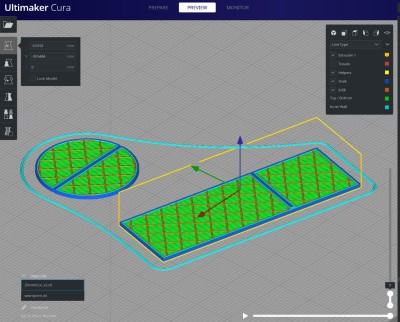

Oh, and no. It's not only S3D. Cura is irritated by these models as well, more or less depending
on certain settings, just like PS.

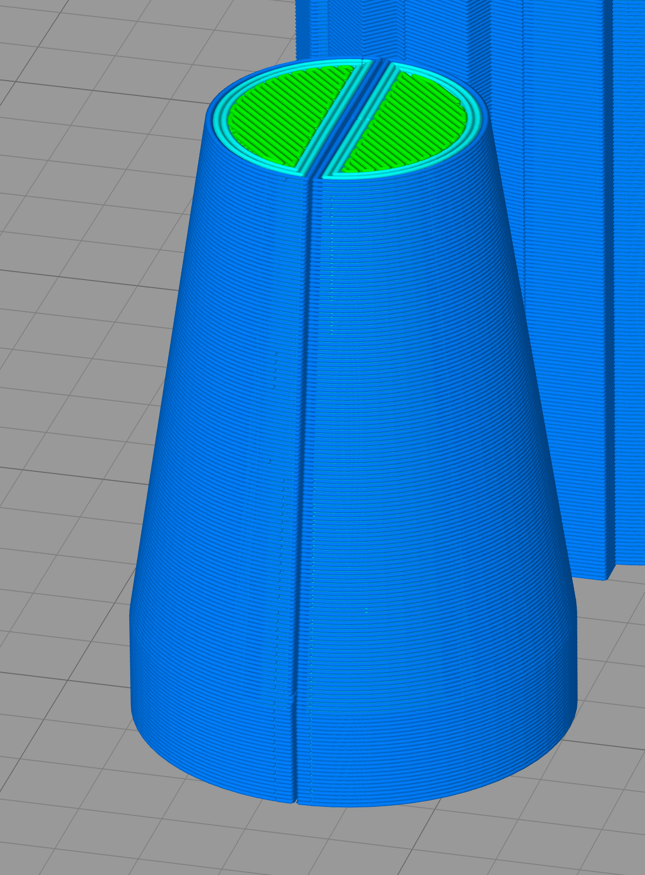

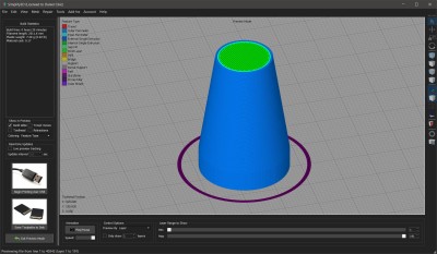

KOPrinting wrote: ↑Mon Feb 06, 2023 8:39 am
bolsoncerrado wrote: ↑Mon Feb 06, 2023 7:50 am Here's the "offending" file...
Under the advanced tab, try changing the Slicing Region Repair mode to Merge all Boundaries.
That did the trick, THANKS!
I mean, the "hole" is gone but the seam lines at each side are still present and ugly.
I also tried the THICKEN+ALTERNATE combo someone mentioned above but the resutls are the same.

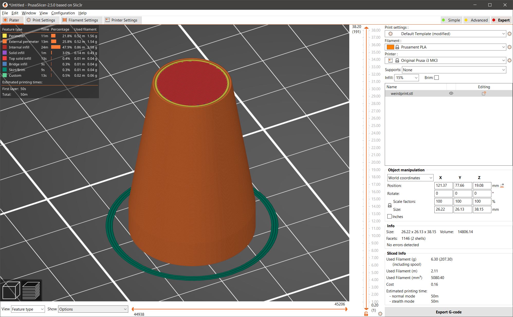

ONLY Prusaslicer did the best job here.
parallyze
Posts: 372
Re: v5.xx slicing Issues. Madness continues!!
bolsoncerrado wrote: ↑Fri Feb 10, 2023 5:19 am ONLY Prusaslicer did the best job here.
All slicers did well - when used with a proper model file. Just because the default mesh error handling of PS does work
better in this one case it doesn't mean that's the perfect solution.

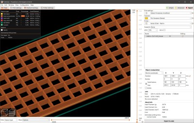

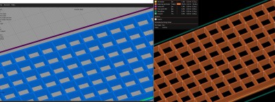

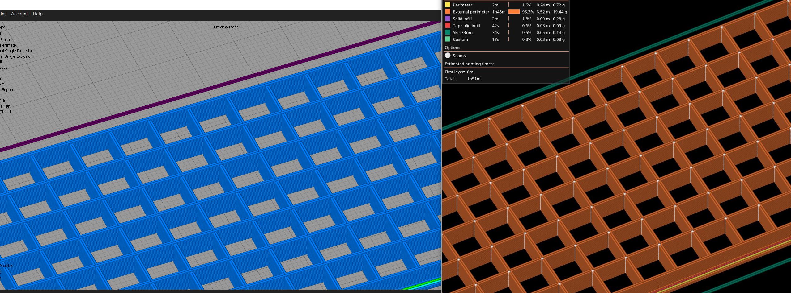

Here... this is a very simple part:
A 27x7 grid. Because there's no relevant forces applied later on I did cut the cells "open" using a
very thin 0.01mm cut.
This is what S3D vs. PS slice using their default settings:
This is PS after setting gap radius to 0.
So you're now really trying to tell me it is better when a slicer ignores small details in a proper model
file, adding more than 4500 unnecessary retracts and a lot of travel moves...?

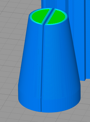

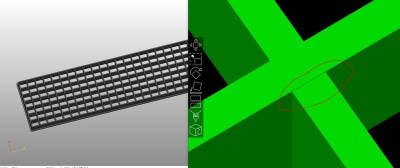

bolsoncerrado wrote: ↑Fri Feb 10, 2023 5:19 am I mean, the "hole" is gone but the seam lines at each side are still present and ugly.
And as said... it's a thing of settings. This is your STL in S3D (4.1.2).
Cheers!
