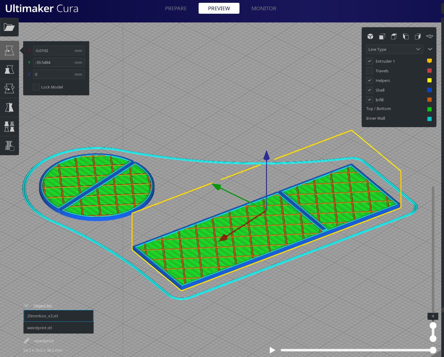

Oh, and no. It's not only S3D. Cura is irritated by these models as well, more or less depending
on certain settings, just like PS.

So you're now really trying to tell me it is better when a slicer ignores small details in a proper model
file, adding more than 4500 unnecessary retracts and a lot of travel moves...?
