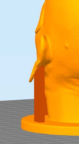

Because I battle with this more often than I should: Here's a head a buddy of mine modeled in zbrush for print. With S3D auto support set to 45 deg (which is silly, since my bot can print > 60), I get this:
So, according to S3D, neither ear (the one on the other side is the same) needs any support under their lobes.
This is wrong on so many levels for "automatic support generation".

You are just using too large of a pillar resolution. It will support that ear just fine if you use a smaller size. You can't expect it to pick up a thin ear like that with such a large pillar resolution.
If you need help, post the STL and I'll be happy to help ;)

Thanks CompoundCarl : I lowered the res to 1, and it put support under them. I could complain that the support is too small and sparse now, so I still now need to manually go in and add more support just so the tiny support towers won't try and tip over during print, but at least that's better.
Unfortunately, this doesn't fix my previous issues/examples, where spikes are hanging down, since they terminate at an infinitely small point, they get clipped out of the "s3d support filter" it seems: The feature is still smaller than 1mm (infinitely small at the vertex) so no "automatic" support for you, regardless of what you set the support resolution to.

Simplify will not create supports for overhangs that are smaller than it's support pillar resolution. It's one thing where it's slicer is worse than it's competition.
A work around is to import a little platform larger than the support pillar resolution and place it where you need it, that way the supports will be drawn to that object which will in turn hold up the real object.
