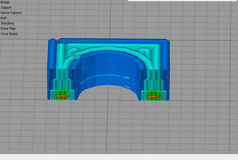

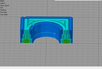

Hopefully a test I've just done will answer the question as to whether there is a bug or not.
I created a shape 10mm x 10mm x 5mm and put a 5mm hole through it. I imported it into S3D and cloned it twice, then aligned the three on top of each other. The bottom piece has a profile with a 0.2mm extrusion width, the middle with 0.4mm, and the top one with 0.6mm.
Here is a screenshot of the preview...which I hope all will agree shows exactly what the slicer has written into the GCode:
Each hole is 5mm diameter, and the centreline of the extrusions around the hole are at differing positions as expected to place the edge of the extruded plastic exactly on the edge of the hole....just as Carl states above in his post.
So, any undersizing of the hole is down to over-extrusion.....and not a bug in the software.
I've attached the factory file so anyone can take a closer look.....

To help the developers resolve the "issue", they need to be provided with evidence of what the software is doing wrong...so someone will need to create an example of where a hole is being "sliced" where the path of the extrusion round the inside of the hole is in the wrong place.
Unfortunately...the test I have carried out and documented in my previous post shows that the slicer is doing exactly as it should be doing...and there does not appear to be a software issue. Any undersize in the hole in the printed object would be caused by too much filament being extruded...and not the filament being extruded in the wrong place.

Your "test" is a graphical depiction?! That's not a test. Are you an engineer? Wow.
I will generate a test case sometime when j have time. Until then instead of the standard model oversizing holes by .2-.3 like everything you get on thingiverse, I have to make my own models and oversize by .8. I'll be moving soon, so I do t have a lot of time to mess around with an obvious test case. Literally all I did was go into openscad, create a 10x10x3 cube, cut a hole out of the center of it that was 3mm. Slice, print, measure hole, look at GCode. The outside edges were compensated for, along the inside of the model. Inside edges whether they were square, round, hexagonal, or whatever, we're all placing the nozzle on the line of the inside hole looking at the *ACCURATE* g-code not a graphical depiction. That's it. I took the maxx, maxy, minx, miny of the innermost perimeter, found it to be exactly 3mm apart, rather than the expected behavior of 3.48 when extrusion width is .48mm. It's that simple, anyone can do it. I've checked a few times, my software says up to date. Perhaps this is a recent occupancy and you've got an older version?
