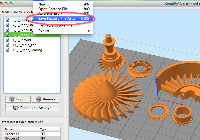

If you post here in the forum to get help, please attach your Factory File (see image for how to save them). This allows anyone else to view your complete work environment (models, settings, supports, etc.) The Factory File is an amazing way to trouble-shoot. Without the Factory File, everyone has to respond with multiple questions. :?

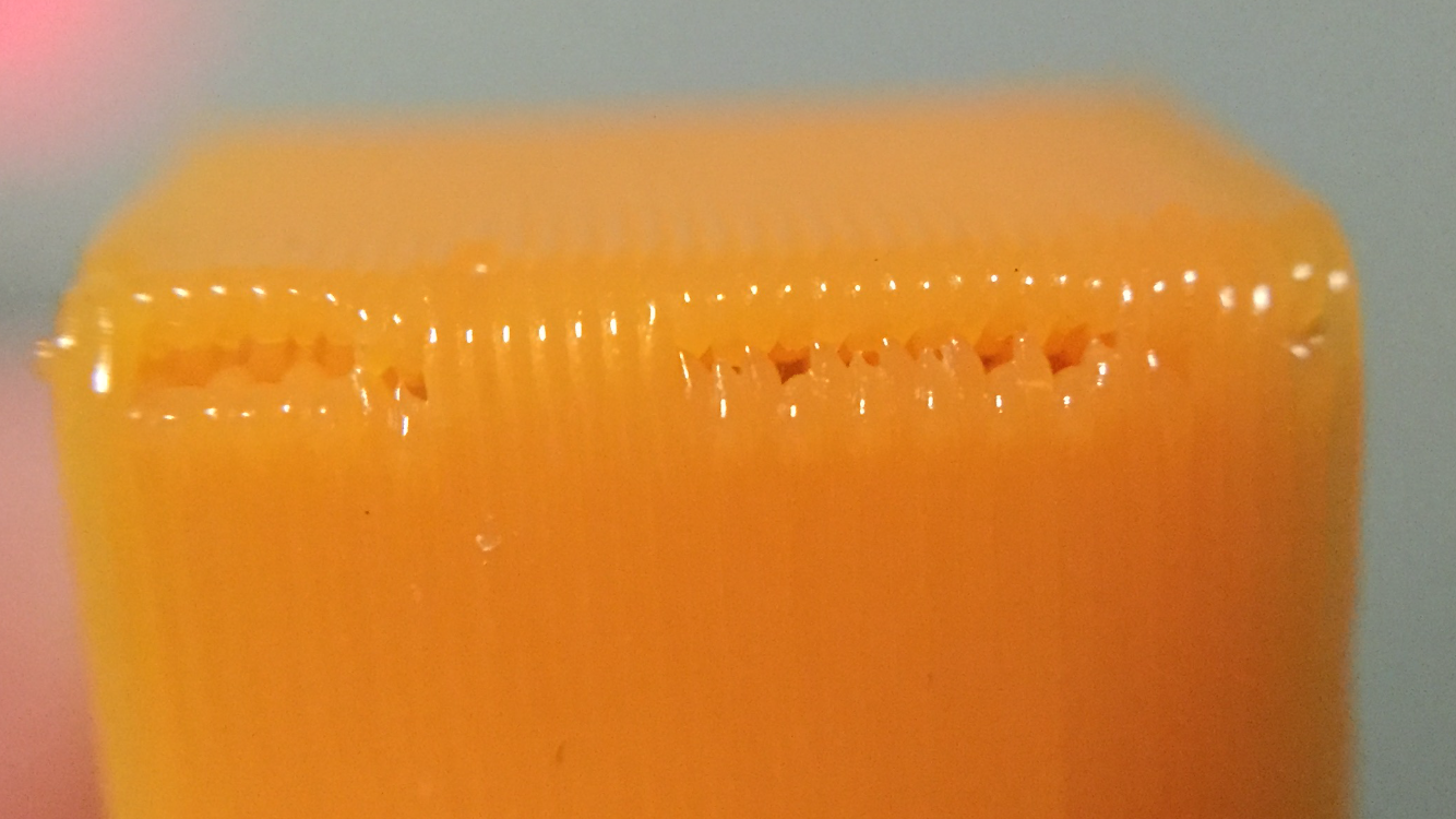

I have now done my first good print, it was an XT60 connector (basically a rectangle) but instead of doing the inner layer and then outer layer (as set in settings) it would do the inner layer clockwise and then do a U turn and do the outer layer anti-clockwise. This results in a 180 degree turn which leaves a gap in the corner. How can I set the software to perform all outlines to happen in the same direction?
The weird thing is that sometimes it would do both the inner and outer layers BOTH clockwise and this results in a perfect finish, the problem happens when it decides to change direction. Has anyone else had this problem?
Could someone please print this file and see if it prints well for you. It only costs less than a cent.
