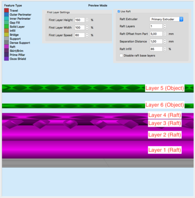

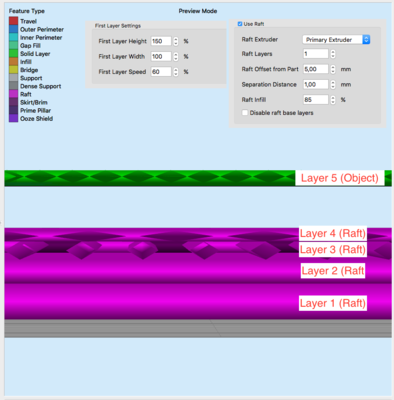

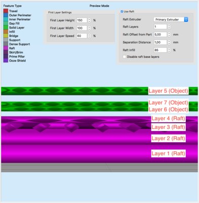

i think there is a bug in the software when using rafts.
The issue is with the placement of the 2nd object layer (layer 6 on the pictures below).
To visualize the problem, I used a seperation distance of 1mm. The same issue apears on a smaller distances, but it would not be as easy to detect on the pictures. Yet you can see the issue clearly in every gcode.
The Problem:
The 1st object layer (layer 5 on the pictures below) is placed correctly, according to the choosen seperation distance.
The 2nd object layer (layer 6 on the pictures below) is then located underneath the 1st object layer. BUG!
The next layers build up ontop of that.
I hope this will get fixed soon. Any help?
~ Tesse
layer1-5: So good so far.
layer1-6: 2nd object layer not placed correctly.
layer1-7: the next layers build up ontop...
