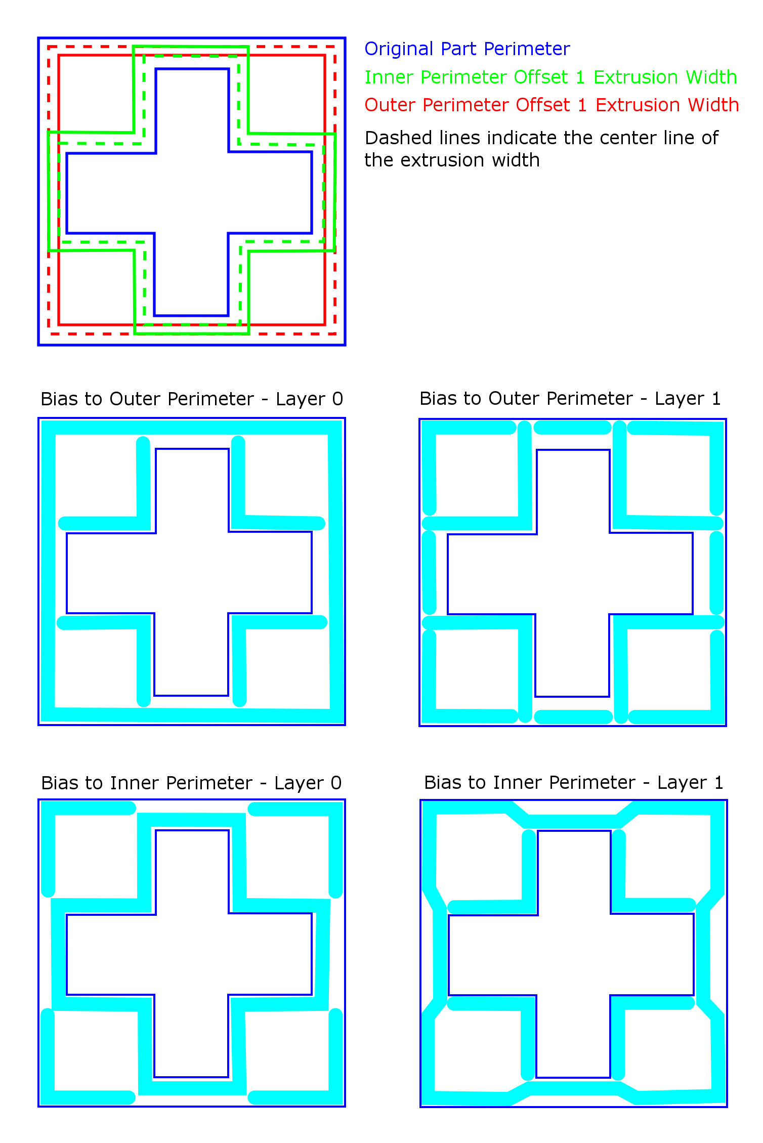

I'd like to see at least 3 options:
Single wall extrusion biased to the outside perimeter
Single wall extrusion biased to the inside perimeter
Single wall extrusion biased to the center line
Here's a picture showing how I imagine biasing to the outside and biasing to the inside would work. The pathing would have to alternate between several different patterns to ensure structural integrity.
