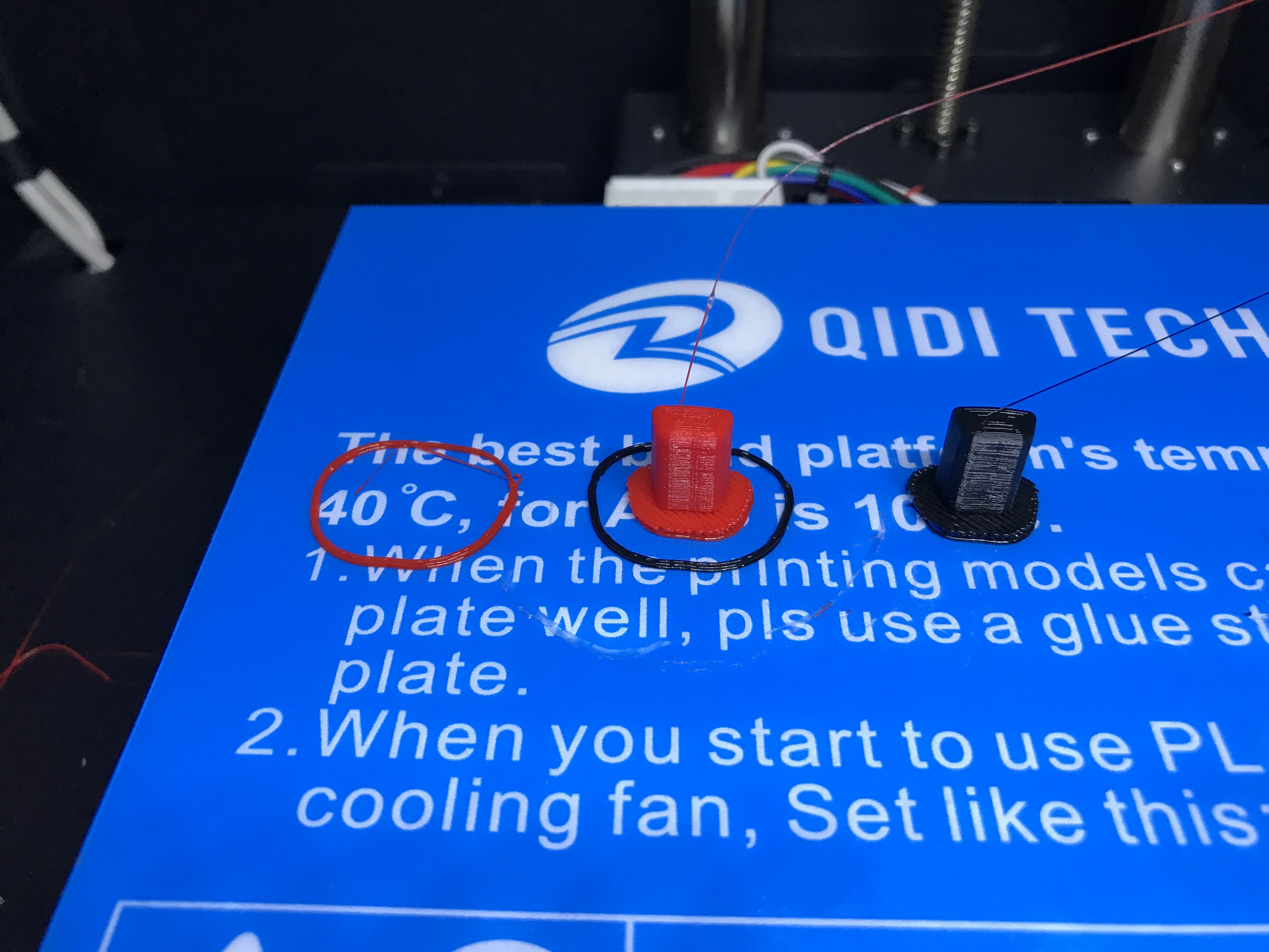

I have the same printer.
My first layers were stringy and uneven on both samples when using ditto mode. Although the same settings for a single part were just fine. After adding a raft and ensuring at least 0.50 mm thickness at top and bottom layers the part turned out okay. Interestingly the skirt printed in the wrong location. See photo.
