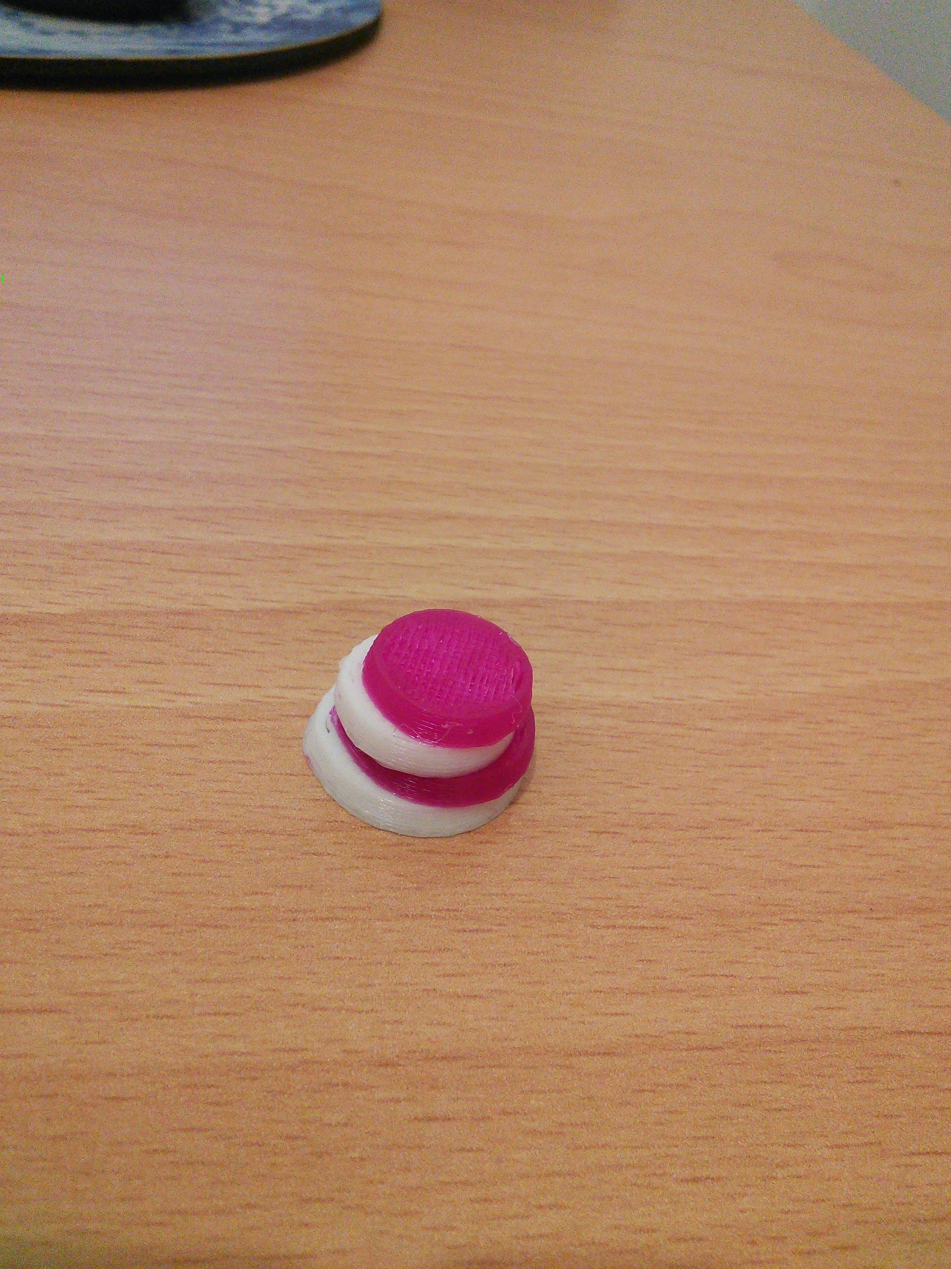

So, I have the same problem (as in the start post in this thread), and I can not resolve.
My flashforge dreamer tips printing with offset (c.a. 2.5mm) when I want to print with dual extruder mode.
(on the image, the green parts overlaps the gold ones, but it shouldnt. This would be a Hilbert cube...)
I did:
- I tried to set the "Tools/Options/Machine/Tool offset" paramters, but It seems like does not working. I tested with other values, but nothing changet. (Also, it forget the stored value, after restart Simply 3D.)
- I measured the tip distance with caliper and it is the same value (34.00 mm) as in the offset parameter....
Please help!
Thank you,
Greg

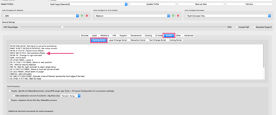

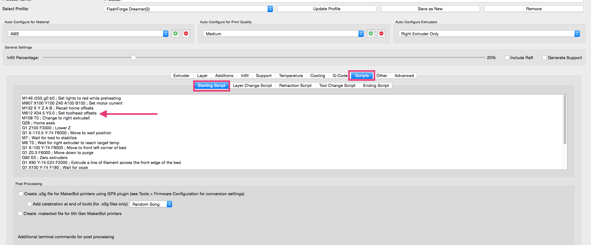

For the FlashForge Dreamer, this is a pretty easy fix!
The main line there "M612 X34.5 Y0.0 ; Set Toolhead Offsets" would be the one you want to change. This line of G-Code is the line that will control how your print looks overall.
