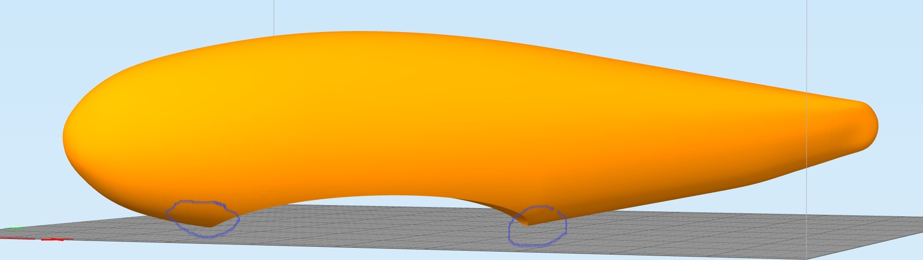

Printing this:

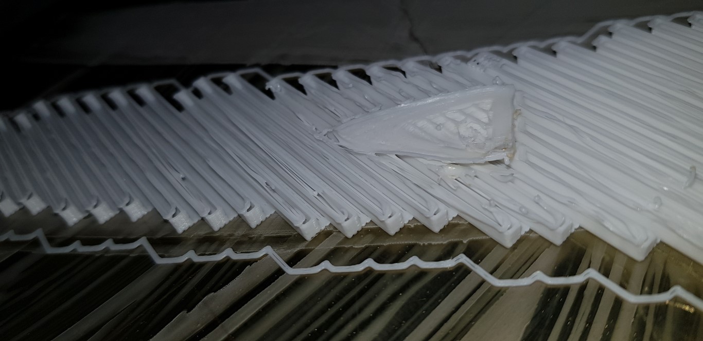

After about 15-20-ish Layers , these 2 parts come loose. (ussing support 40%, support base layers 0 , dense support 0)

Last night I played araound with the support settings , made infill percentage 50% and dense support layers 1. Although I got a useable print the support is very thick , and way too much.
I think the problem is , since it is a pointy/ ball form , and almost does not touch the bed, after building on it , it becomes unstable after several layers and than just brakes off.

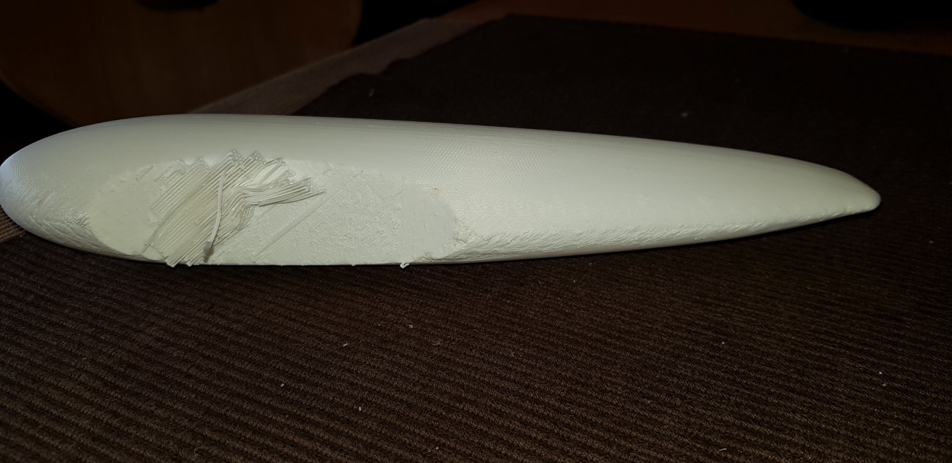

Also the bottom part is very rough:
Maybe due to the support? any solutions for this , although this is not the most important , I can sand it. But it would be nice if the bottom part of the model comes out a bit better.

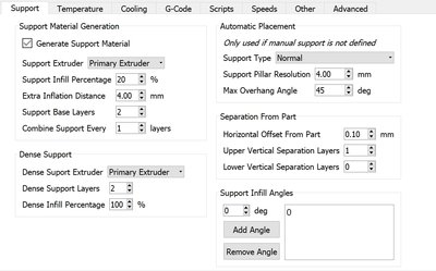

This is where dense support comes into its own.....
Set the following:
* Support Infill %age of say 20%,
* Extra Inflation Distance of say 4mm
* Support Base layers of say 2
* Dense Support Layers of say 2 or 3
* Dense Infill %age of 100%
* Horizontal Offset of say 0.1mm
* Upper vertical Separation of 1 laye
Try printing the model agaim. You may want to have two profiles...one for the lower half and one for the upper half so you can have different properties for the upper and lower halves.

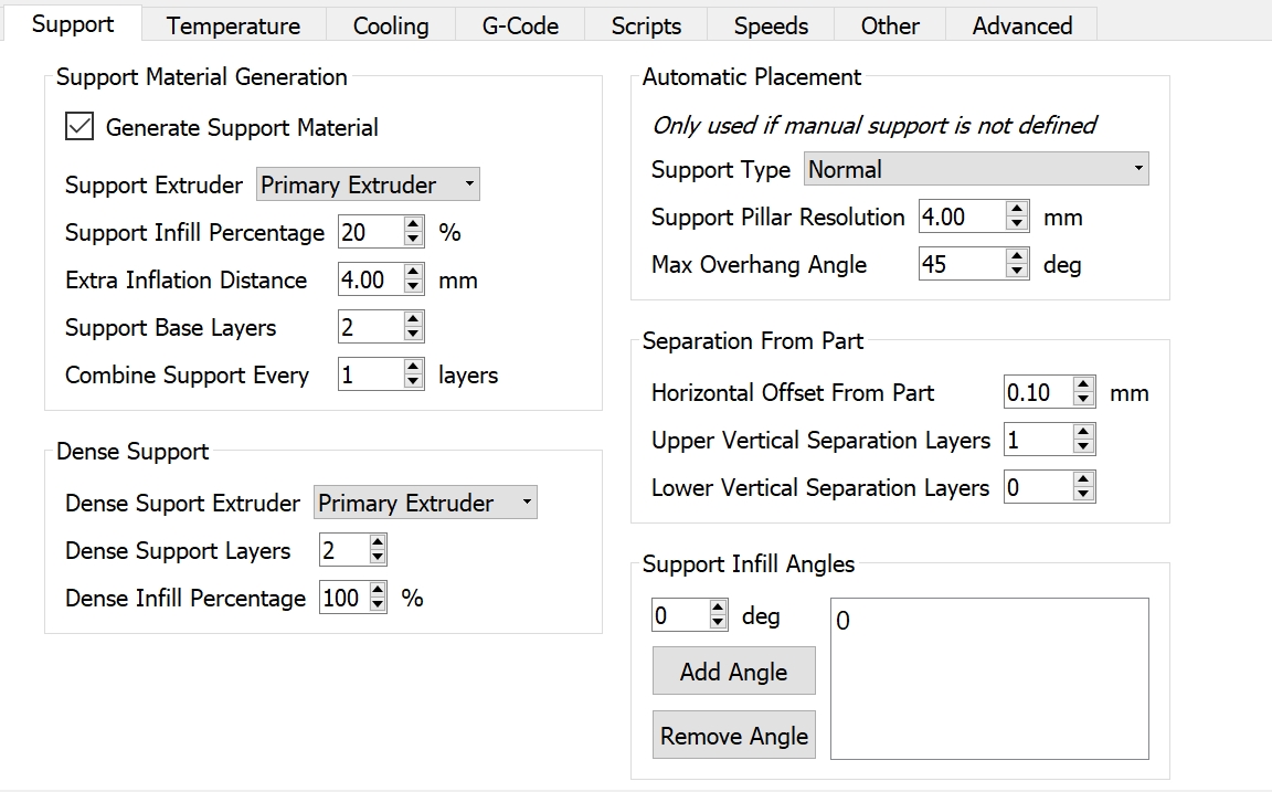

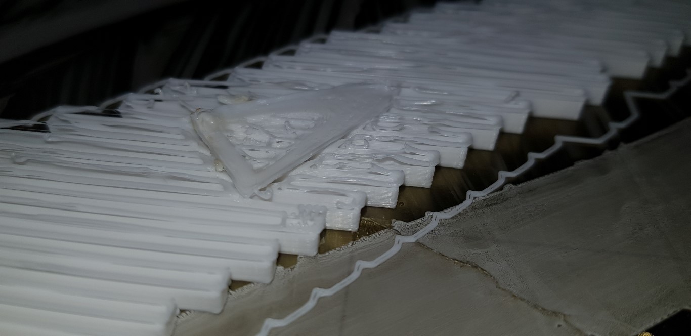

@dkightley: I just tried with the settings above and I had to stop after a couple of layers. The beginning looked good, a nice white surface., but then after about 10-15 layers , suddenly the layers didn't look right anymore:
What am I doing wrong?

Regarding ‘..after the ~15th layer…’ Things to consider:
• The material being laid down within those layers is warm from the heated bed and extrusion but, then it cools. At the 15th layer, the Fan further cools the material perhaps too quickly - causing shrinking away from the layers it was extruded on top of before is adheres.
You can reduce the Fan to 40% speed and position so it's not blowing directly on the new extrusion.
It looks like something happens at the layers where it goes bad:
Are your Temp settings changing at that layer?
Print speed too fast and/or changing?
Can you successfully print other items beyond 10 to 15 layers?
Perhaps aside from this issue; I suggest setting your Acceleration Jerk to a low value of around 2 to 4. (Some Prusa machines have the default at 20. That will shake the machine apart and cause print problems).

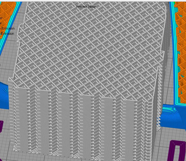

Re: Ball form comes loose from bed
And to make the support a little more rigid, try setting the Support infill angles to 45, 45, 45, 45,45,45,-45
The support will look like this....
This technique works well on tall thin supports....gives it a lot of strength.
