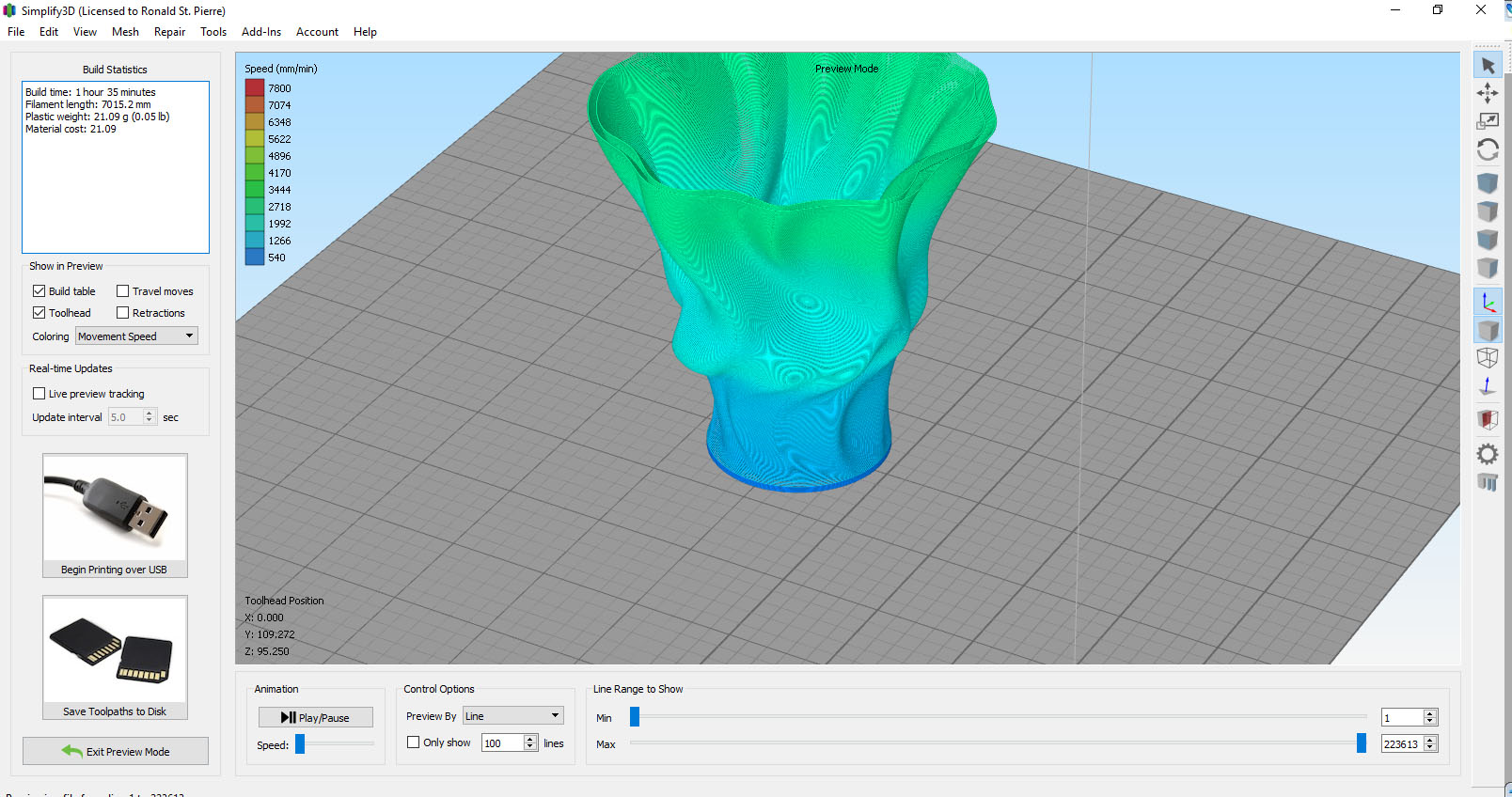

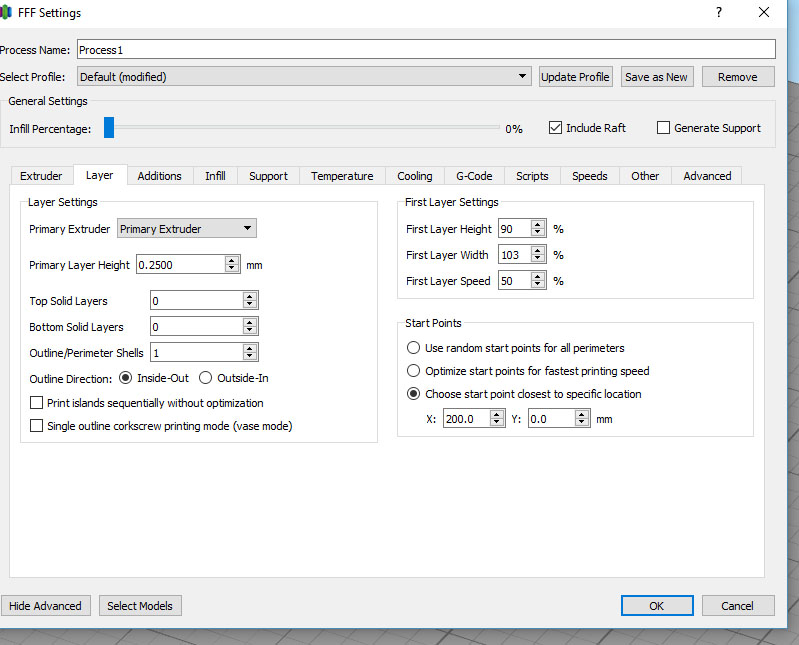

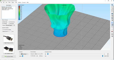

When I edit the process settings to add a Brim, Skirt or raft, Simplify3d does not add any of these to the model as shown in the pictures attached! I have tried 10 different models whit the same results.
What is wrong?

A quick tip which may help with this. The skirt/brim and raft features will not be generated for your print if the model begins printing off the bed from the start.

A quick way to verify your model is on the bed is:
Right click and spin yourself around so you are looking up from under the bed at the bottom of you model.
Hit Control-L then click on the bottom of the model
If it moves you were not on the bed.. see if you get your skirt now..

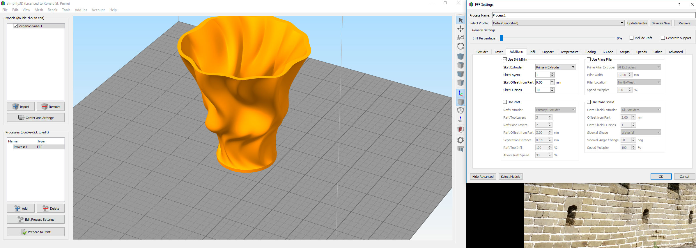

Was this resolved ? I have the same problem and my model is on the bed. Factory file is attached.
Thumb-Screw-v1.factory
(9.51 KiB) Downloaded 460 times
S3D-Alex
Posts: 456
Re: simplify3d does not add a brim, skirt or raft to model
I looked at your Factory File and was able to see the Skirt you have turned on for this. The Skirt lines seem to be hidden under the overhang of the part. If you would like these to be visible you may need to increase the Skirt Offset from Part. Please let me know if you are unable to see these.
