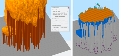

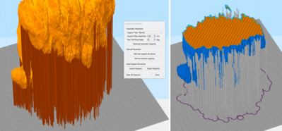

At fine resolution generation (default 2mm) it creates lots of small individual pillars which due to the nozzle diameter either don't come out in the gcode at all or are made of broken lines that presumably wouldn't come out in a print (see attached screenshot 2mm supports).

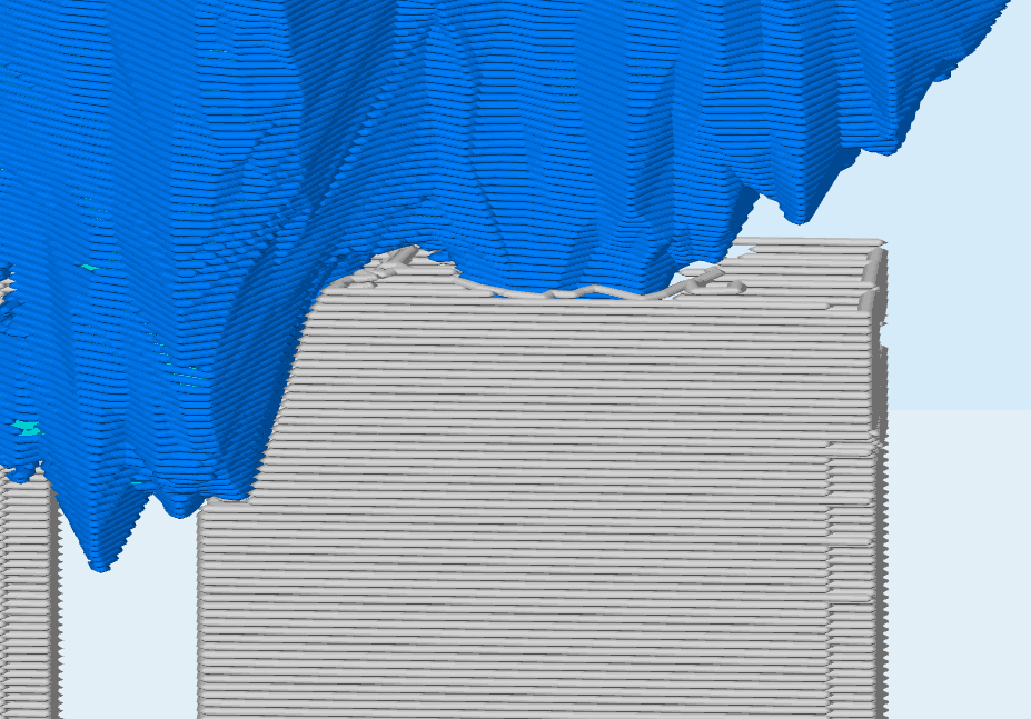

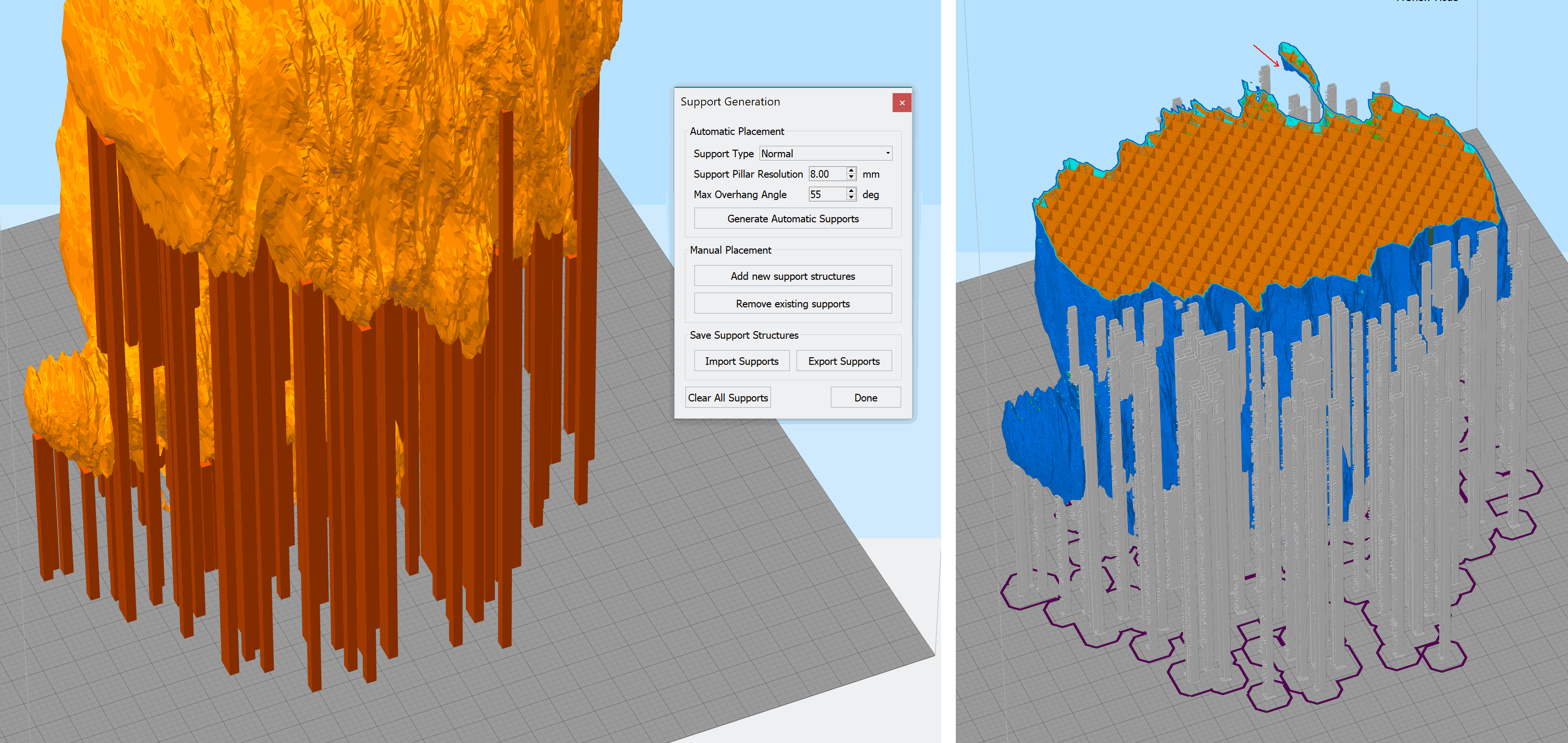

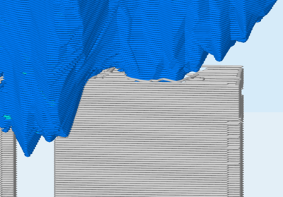

Low resolution generation (for example 8mm) come out fine where support pillars are present but the software often misses parts that need supporting entirely (see attached screenshot 8mm supports) and also don't always continue as high as the need to support all surfaces (see attached screenshot supports ending early)
