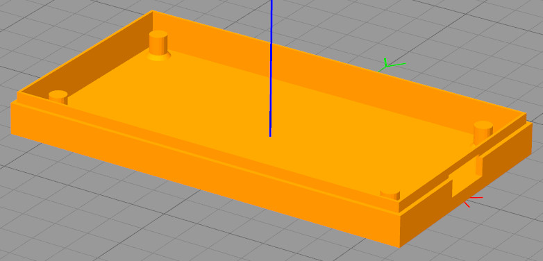

I have designed a simple box for a project I'm working on that includes a lip so that I can attach a lid. I can import the shape into S3D and it shows correctly in the main window:

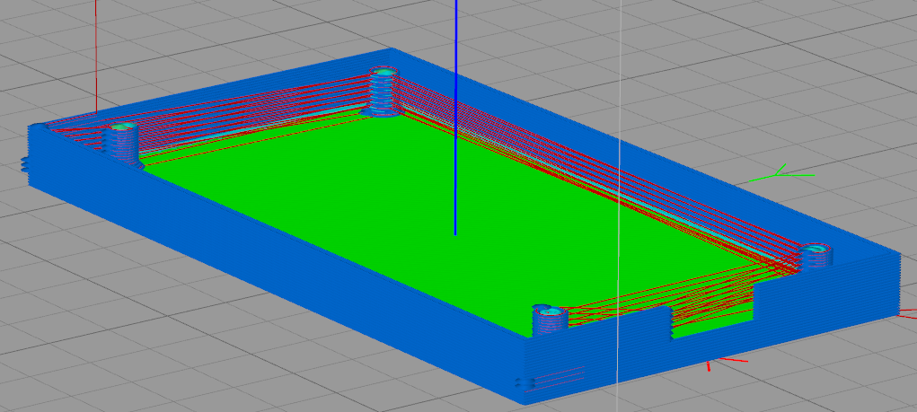

However, when I click the 'Prepare to print' button, the print preview excludes the lip and the resultant print matches the print preview:
I can only assume there is something wrong with my print settings but I am not sure where to look for it. I've tried changing the top solid layers and the perimeter shells without success.

The "missing" lip is thinner than the extrusion width that you have set up in your settings....and S3D will refuse to print it as a way of advising you that the shape cannot be printed. Obvious, isn't it??
What you need to do is to change the Thin Wall Behaviour in the Advanced tab. Change the External Thin Wall Type to "Allow Single Extrusion Type" and then set the Single Extrusion Printing Width to ...at a guess...50%.
You should get the lip showing in the preview....and printing.

That fixed it.
Thank you so much, Doug!
