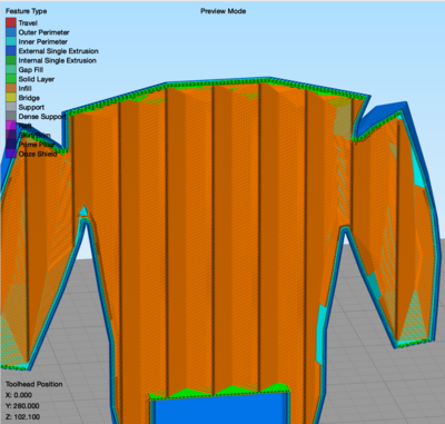

I’m happy to state that this issue should be resolved now in the latest 4.1.1 release. Our team successfully tested your factory files from threads mentioning this issue. The top solid layers will perform much closer to how they did in 4.0.1. This was just one of many improvements to the software. All of which are detailed on our Release Notes page.
Torso Factory 4.1.1 cross section
