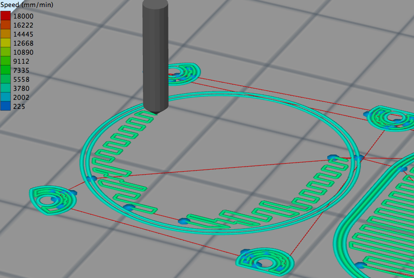

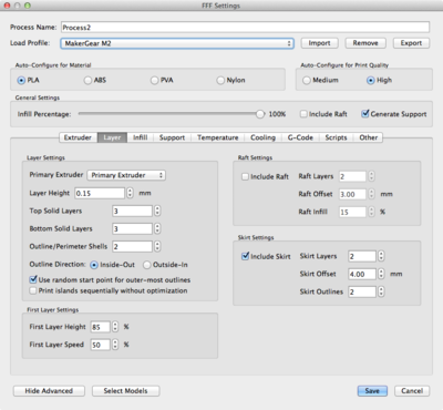

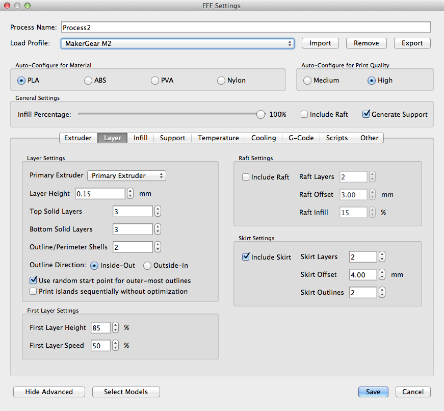

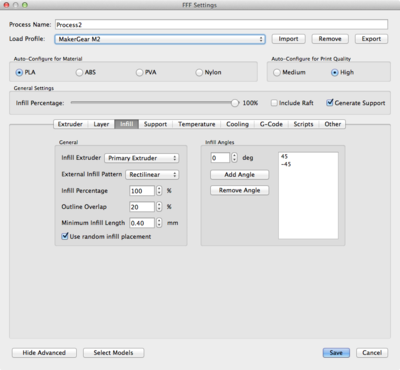

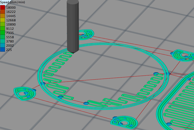

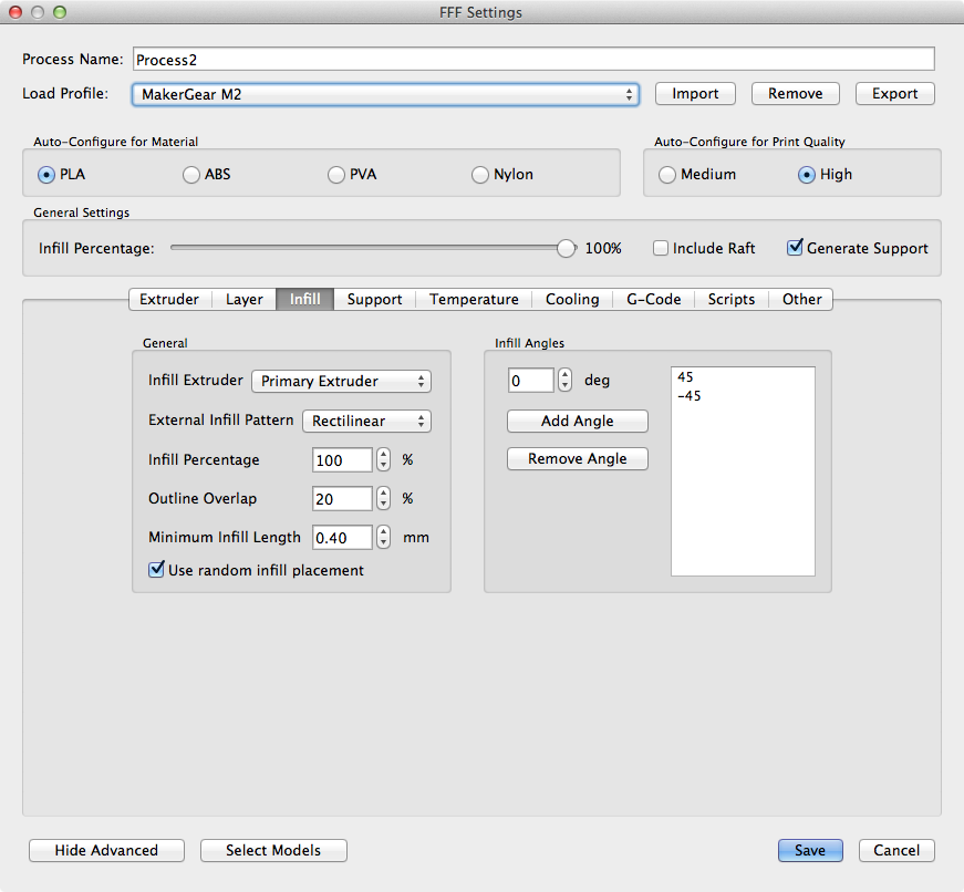

I'm having a similar issue. I tried your suggestion and it's not filling in a 2mm wall - note the hollow circular feature - at minimum I'd like to see a inner wall filling it in if infill isnt an option due to the thinness of the part.
Any furthur suggestions?

With your settings it wants to put 4 lines with the number of walls set to 2, but it cant fit 4 in there so it drops the 2 inner. It could be possibly fixed with increasing your first layer height to 100% or more. When the first layer height % is lowered it spreads out the infill and can cause the problem you are having. If you are not set on 2 walls for thickness you can also reduce the number so in has an infill rather than a perimeter style.
