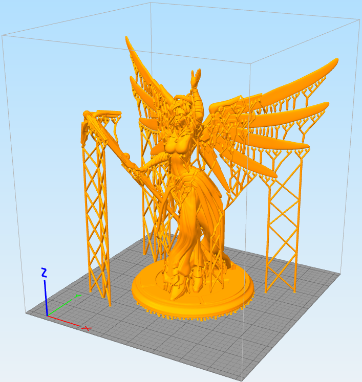

Lets face it, supports are a pain sometimes. I've had issues with supports ever since I have been printing (about a year now). I recently installed Meshmixer and their supports are completely different from what S3D uses. Meshmixer's supports are like pillars that branch off to other parts of the print and are really easy to snap off when the print is complete. The issue i'm having at the moment is when I move the model from Meshmixer to S3D it adds gaps in the support structures for whatever reason. I've read that using the "Separate Connected Surfaces" fixes this, the issue with that is when the model has a crap ton of these connection issues S3D "Stops Responding" for hours before it finally decides to do its thing. Can we get supports like the ones Meshmixer uses to rectify this problem I am having? I'm sure many other people would like these to.

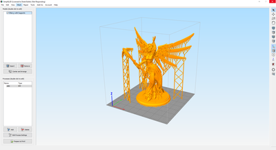

Continue reading and you will see that I do. "the issue with that is when the model has a crap ton of these connection issues S3D "Stops Responding" for hours before it finally decides to do its thing." Ive been sitting for the past 3 hours waiting for S3D to finish but all I have is the image below. (Notice in the top left it says "Not Responding") That's the issue with S3D I am having.
"however cloning how other software works is not that clever!" Then why not stop with the default of adding gaps? I even put the model into Blender, joined all the meshes together and I STILL get the damn gaps.
