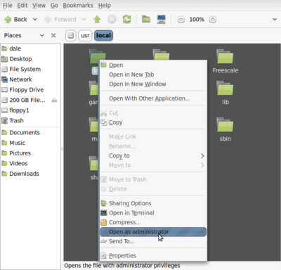

Okay, different file manager or desktop manager, I guess. In my old Linux Mint 11 / Gnome2 system, if I right-click on a folder, there is an "Open as administrator" option:
Folder /usr/local, opening ./bin as admin
On my notebook, Linux Mint 13 / Cinnamon, it's "Open as root". Not sure what straight Ubuntu (Unity? Gnome 3? Gnome 2? Other?) uses...
