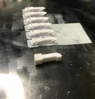

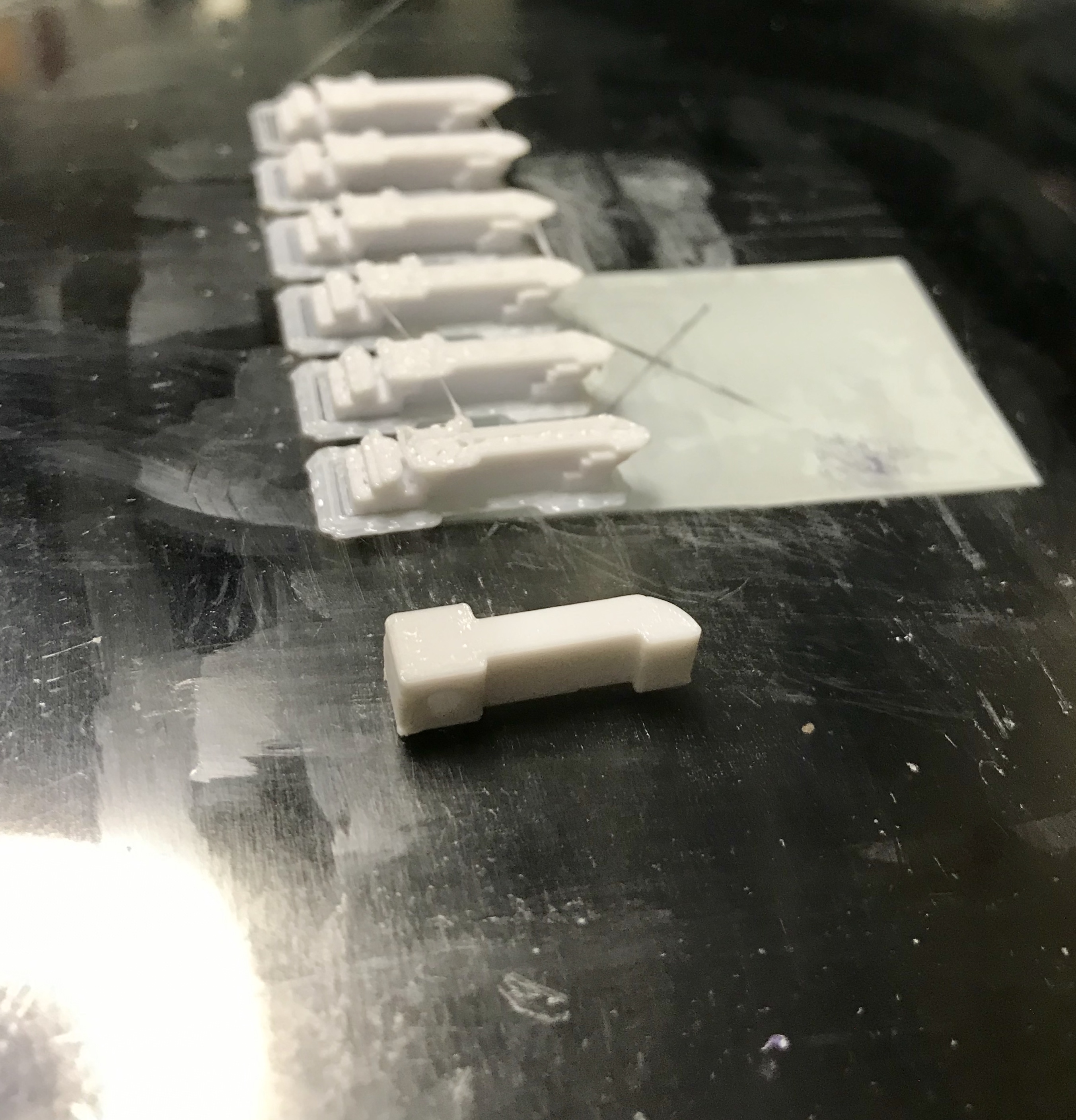

I never had a situation like this before. Printing a single object turns out great. However, when I duplicate it and try to print several at a time, I get a layer shifts after about the second or third layer. Everyone after that shifts a little more in the same direction. Maybe 3-5mm. Any explanations would be appreciated so that I can correct the problem. Belts are tight.

It looks like this might be happening due to some over extrusion and/or curling. So when the nozzle goes to deposit the next layer it doesn't quite clear some of the previous layer and this can cause layer shifting like you see here.
The best way to fix this is to eliminate the over extrusion and curling. Some first steps to take would be to make sure you are printing at the lowest reasonable temperature for your material and to slow down your print speed to ensure each layer has time to cool before the next is deposited.
