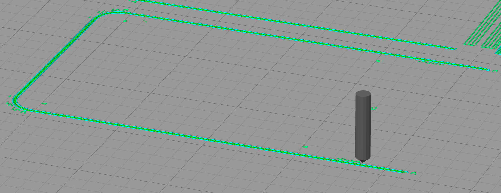

This is at layer 5 where only few support is generated at the inside corners:

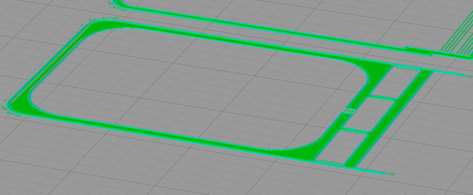

This at layer 6 with a much wider infill with almost no support underneath:
Does someone know which support setting to tweak to get support printed for the whole new solid layer?
