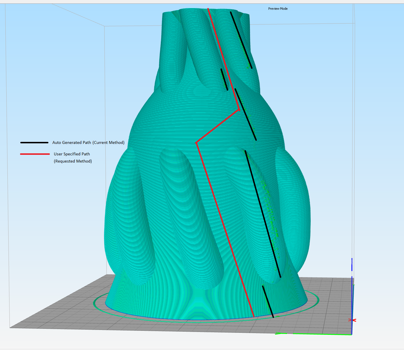

I also want to point out that using the feature in this way creates irregular, inconsistent start lines on the print, which for some prints is completely useless or somewhat obtrusive.
As an example, I have attached an image showing what I'm thinking of.
I'd like it to work more like the tool where we can add supports. (Which, as I'm mentioning, needs an option to delete a single support instead of just clear all or nothing).
I'm not saying the current implementation isn't good, it's just not great because the control is limited.

Rewire wrote: Thu Jan 31, 2019 8:18 am I also want to point out that using the feature in this way creates irregular, inconsistent start lines on the print, which for some prints is completely useless or somewhat obtrusive.
On the supports you can delete supports you want by selecting the remove support button and then clicking on the individual supports you want to remove.

I really want to be able to just draw a bunch of lines to tell the slicer where I want the new layer to start.
Any functionality less than that won't be worth it because it's still unpredictable and not fully user controlled. The slicer just does whatever it thinks is "best", which isn't always going to be ideal as you can see from the picture I posted.
