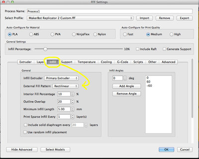

Infill Settings Screen Shot
KeyboardWarrior, in the image above you can see that in Simplify3D there is indeed EXTERNAL INFILL. In the attached image, on the Infill properties page, the EXTERNAL INFILL is specified by the External Fill Pattern option. You can select two options, either rectilinear or concentric. Concentric makes a circular pattern, while the other simply uses the INTERNAL INFILL pattern set at 100%.
In FFF (or FDM, same thing) 3D printing each object is composed of 1 or more layers. When the 3D printer is printing a layer, it's divided into shells and infill. That's the terminology used by slicing software. If the layer is the top or bottom layer, then the infill is called EXTERNAL INFILL. The only time you call infill INTERNAL INFILL is when the infill is not seen in the final print. All other infill is called EXTERNAL INFILL.
A solid cube for example can be composed of any number of layers. The first layer, the bottom layer, for a cube will contain 1 or more shells (outlines at the perimeter of the layer), and EXTERNAL INFILL of 100% to fill in any space between the shells. The top layer will be the same. The layers between the top and bottom layers could contain 1 or more shells with INTERNAL INFILL that's from 0% to 100% to fill in any space between the shells.
Note that it is possible to make an object that's 100% shells, without infill, but this is very slow and takes a lot of plastic, so most people use internal and external infill and just a few shells.
You cannot call the external infill a shell unless its drawn using shells. The external fill patterns is not a shell. Shells are outlines of a layer and are typically the outermost portion of a layer and are typically drawn without patterns, just outlines. Infill is typically drawn with patterns, whether external or not. However, you can have an object drawn without EXTERNAL INFILL, and just shells, like I said above, it's slow and wastes plastic.
Do you see the difference of EXTERNAL INFILL vs INTERNAL INFILL vs SHELLS?

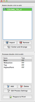

I wonder if the technique of using multiple settings within one model would help you?
http://www.simplify3d.com/support/tutor ... f-a-model/
For example, I build the Colonel model with 4 settings: http://www.thingiverse.com/thing:108867
I changed the external infill in each section - not with any real purpose, but just to see if I could vary the settings easily. I'll attach my Factory File.
I might not have figured out everything you wanted to achieve, but I wanted to pass along the idea.
Also, if the software offered 3 settings, we would want 5. If it offered 5 settings, we would want 7, right? :)
Colonel_w4_Settings.factory
4 settings applied to one part
(2.36 MiB) Downloaded 796 times

Tri-lite, you give a good example of one of the great features of Simplify3D. No doubt, that's one of it's strong points. That layer profile trick does some of what we're talking about for sure.
With that trick I can even insert custom G-code at the start of a specific layer, and only have the custom code happen 1 time. It's a great feature.
