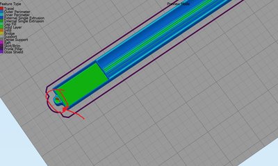

Hello all ,
I am Making a small case for some electronics and some batteries. Both ends I want to insert a screw. Infill is 15% which is fone for the print , but the 2 ends I would like to have 100% infill . is this possible? I read it is possible to make a hotizontal part diifferent as the rest of a print , but I couldn't fine anything for a vertical part.
The part circled red I would like to have 100% infill.
Many thanks,
Cor

The first thing that comes to mins on a small area like that is to increase the number of perimeters and see if it helps. It increases them for the whole print but on a small area it may make it solid.
You can also look on the infill tab and see what the min infill distance is set at. Default is 5 I think so you could reduce that and it may help.

@ Wirlybird: yes , playing a bit with the infill tab made the difference. Maybe in the duture it will be possible to make parts of an object with more infill as another part.

One thing I did was to "drill" some very small holes through the area that I wanted filled in. I don't recall the size, but maybe .004". Going too small caused issues with the STL file. S3D then drew perimeters around all the little holes, so by matching the hole spacing to the total perimeter X2 I was able to make just the desired areas of the model solid.
