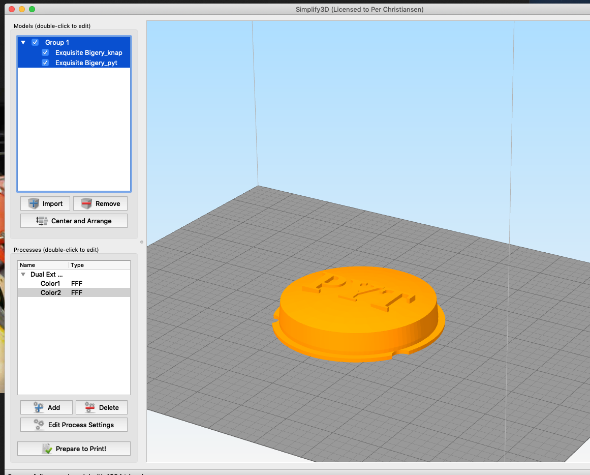

When I use the dual extrusion wizard, I get some odd joining of the two objects when slicing.
In normal view
when sliced:
Any ideas whats going on here?
Re: Odd Joining of models after dual extrusion wizard
Can you attach your factory file?
Have you tried previewing using active toolhead mode rather than speed?
