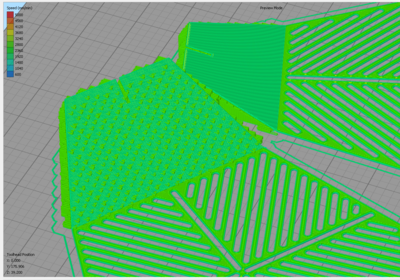

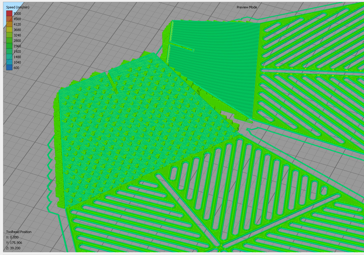

Top of supports appearing above object
Interesting: 2 blades with different angle, one is supported correctly, the other shows a part of the support ABOVE the blade. The only solution here was to set the "lower vertical separation layers" to 7. The problematic angled blade is around 53 degrees.
Posts: 1374
Re: Top of supports appearing above object
Try reducing the inflation value to 0 and see if it helps. Also the support infill percentage and the pillar resolution can potentially help.
