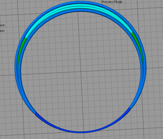

You have a wall the model with a front and a backside. And both together have ~ 0.54 mm or 0.27 mm each one.
Undependend of your nozzle of 0.6 mm the perimeters will be printed when Layer Width is max 0,25 mm.
In this point S3D is sensitiv and will not print this area because in sum the bottleneck will have twice Layer Width.
The bottleneck is a doubling of the perimeters where only one perimeter is needed - mission impossible!
The front and the backside of the model is inevitably. Thats the same with news papers, as thin as possible it has 2 sides. The only solution to print it in a simple way is to interrupt the wall and set a only one strip with 0,5 mm width between the ends. But it needs to print with a Layer Width of also 0,5 mm imperatively.
I'm sure that further versions of S3D could print it but version 4.0 and later are not able for this .
GER
I'm sorry, Version 4.0 and higher is also able to print it!
Example:
