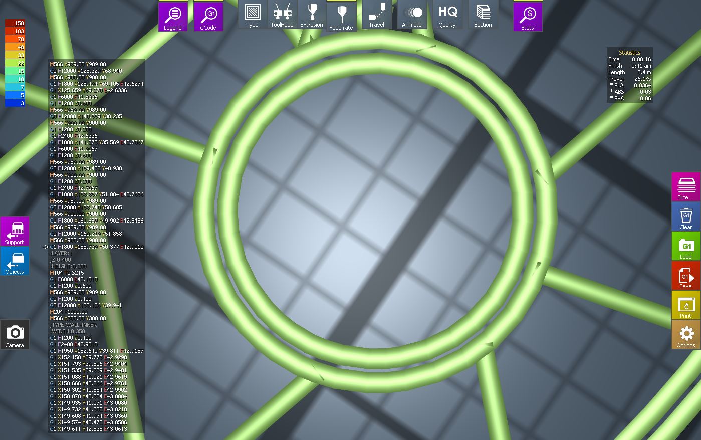

If S3D increased their resolution: parts would print faster, be more accurate, look a lot nicer, and would be easier on your printer, mechanically. "
Please improve the resolution at which the GCODE is exported. Due to the rough nature of S3D GCODE, parts print slower and rougher as opposed to using cura and ideamaker. If identical items were sliced with same speeds and comparable settings with cura, you’ll notice that S3D will finish last. This is because of how jerk handles the little segments of GCODE(S3D are bigger, Cura's are smaller and more precise). If jerk is turned up on the S3D print, it would be right up there with Cura in print time but would alter print quality (probably worse) since you’re running a jerk setting above what you normally use and what could be unsafe for your printer. I’ve done many tests to prove this and have a few images that clearly show the resolution S3D has versus others.
Cura by far has the nicest GCODE I've seen.
Test it yourself. I've successfully proven it on a makergear and ultimaker.
Image order: Cura, S3D, Ideamaker
As you can see, S3D's gcode segments are quite larger than Cura's and Ideamaker, therefor reducing quality. A circle is never a circle. A circle is composed of many little segments. The more segments you have, the higher the resolution.

Thanks for your feature request. You mention having printed the same model in at least two of the slicers mentioned. Would you care to post your G-Code files and or images of the printed results? This may be a result of Simplify3D filtering out segments that are so small they would trip up the logic in some previously problematic firmwares. I can't know for sure without really seeing the results and print files. Either way, if you've proven with actual prints that this is an issue I'd love to present more of a full report to our developers.

Here are the two Gcodes. I matched the settings in cura as well as I could with S3D. You can easily see the difference in resolution between the both. The file size also speaks for itself. We can both agree S3D has better/optimized printing movements over cura, but a lower resolution in those movements.

The print at 100% on S3D was horrific with terrible machine sounds and a poor printed part. Finally at around 75%, the print quality went up, and printer started to sound OK again.
The S3D GCODE I attached sounds really bad when printing curves and holes. If XY jerk is increased, the XY sound disappears, but starts to skip steps.
