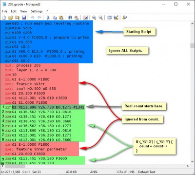

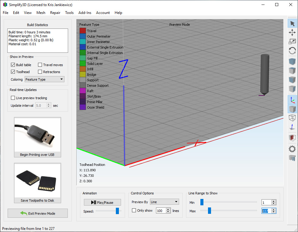

The gcode file has a lot of commented out lines and setup gcodes. When the file is previewed in S3D, it counts those lines that IT SHOULDN'T. The count should start from the FIRST "G1 X" or "G1 Y" command and EXCLUDE all others.
See attached pictures. The first movement of the first layer starts at line 227. The gcode has 226 lines of comments and setup commands. The first G1 X/Y command is on line 227.
All scripts should be immediately ignored. The only lines that should increment the counter are those starting with G1 X or Y.

in no case can this be changed! This shows the line in the file, which can be changed in the file.
