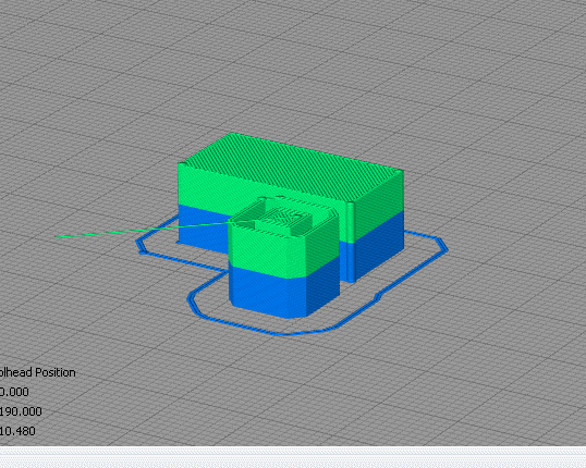

Voilà .... no problems here!
Opened the factory without any changes.
I have tested yesterday a 2-color-print with versions 4.1.0, 4.1.1 and 4.1.2 , always ok.
H.
PS:
I attache the gcode, comming from your factory. You can compare it with yours origin.
You can also import it in your installation (menu FILE, Preview G-Code file) and for testing you can import it as FFF (! - obtain extension .fff)
H.
Dual.gcode
(539.74 KiB) Downloaded 355 times
