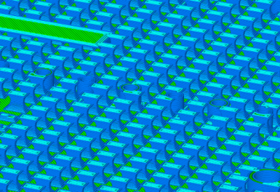

What is happening is I have these areas inside the print. The top edges of each little rectangle start to curl a slight bit when they reach their final couple layers which is unavoidable.
This printers travel moves are extremely fast (350mm/s x/y) and set by the maker in their S3D profile.
The nozzle grates across the tops at high speed and is catching the edges and breaking them off.
My two other machines I use move much slower for travel and you can hear the nozzle hitting but it never breaks them off.
My other machines use an MK10 nozzle which has a much smaller tip area than the nozzle on this volcano hot end even though they are all 0.4mm.

TheBum wrote: ↑Mon Jun 10, 2019 7:29 pm Have you tried experimenting with the Avoid Crossing Outlines for Travel Movements setting in the Advanced tab of the profile?
I thought of that and set it but it looks like in the preview that it is still crossing it.
Maybe it takes a really high number to get it to stick to the perimeters which would be ideal.

The Avoid Crossing Outline feature is not appropriate for the model as per your screenshot. The "outline" is being crossed on every move!
Avoid Crossing Outline is useful for objects that for example are horseshoe shaped....where a path from one point of the horseshoe to the other end of the horseshoe can be diverted to follow the shape....rather than zipping across open space!
Retraction Vertical Lift is going to be the option to go for. Messing with flow, etc may not yield desired results....particularly with a Bowden printer!

Thanks Doug, that is what I thought. I do use it on another part to keep the extruder travel within the boundaries of the part. Works well there.
