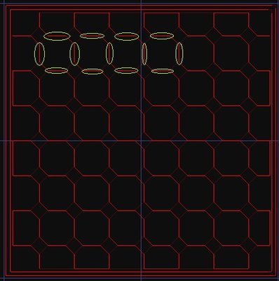

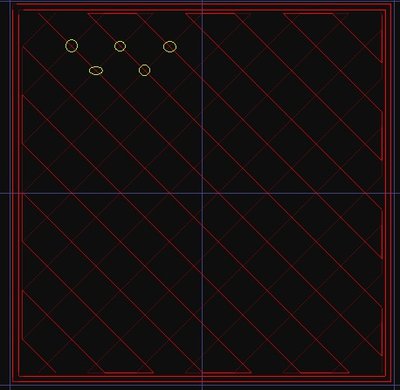

I have attached two examples from KissSlicer. I have circled the places where one layer of infill touch the layer below it.
On the hash it only touch where it crosses the previous thread.
On the honeycomb it touches the previous layer in much bigger spots...
