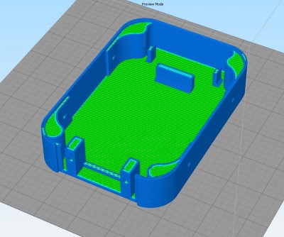

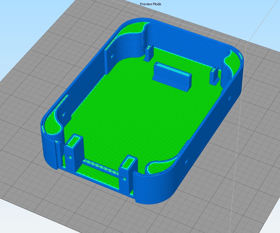

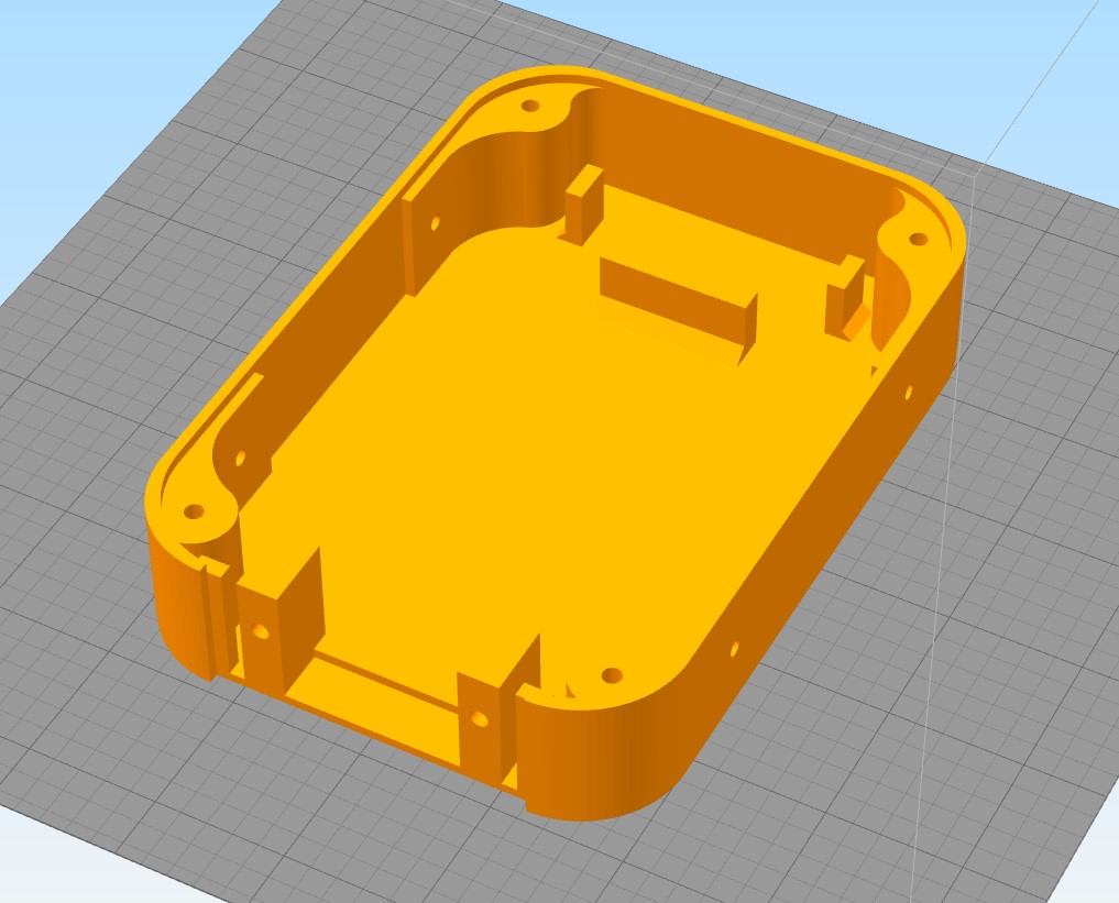

I have this design and after slicing - the top through holes are removed.
Anyone now what the "fix" is ?
The same .STL file slices perfectly fine in Cura 4.2.1 so I suspect it's not a problem with the .STL & it printed fine.

I adjusted the layer height (both up & down slightly) as you suggested and no change unfortunately. The top holes are still "missing" I'll re-run my design through my 3D modelling packages error checker and see if anything crops up. Pretty sure I did do that before though. The odd thing is Cura slices it perfectly, which is what I ended up having to use to print the design.
