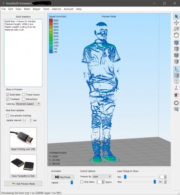

I have an .stl file that I've been printing on my old printer with no problems. Now I did a reset of my simplify3d when I bought a new printer and the same file looks strange when I try to prepare it for print. I'm obviously missing something simple but I can't figure out what it is.

You can try selecting Separate Connected Surfaces in the Mesh menu.
Re: .stl model missing parts when prepare to print
...its either that (because there's more than one mesh in the shape file) or the stl is hollow with a very thin wall....in which case the Merge all shapes int a single solid model is the option to use.
PS Always best to explain why you're suggesting something....otherwise knowledge won't be spread!

I first tried to "Separate Connected Surfaces" which created an inverted copy of the model. This might work if i try to print the model but I feel a bit worried because it's two models involved...?
Then I tried "Identify non-manifold edges" which seems to do the trick. There seems to be one single solid model.
Where can I find the option "Merge all shapes int a single solid model"?
Thanx for all your suggestions and explaining!
Advanced tab.....bottom right.
